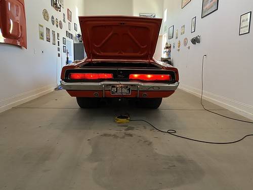

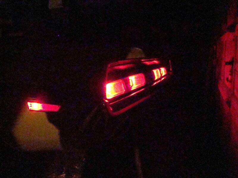

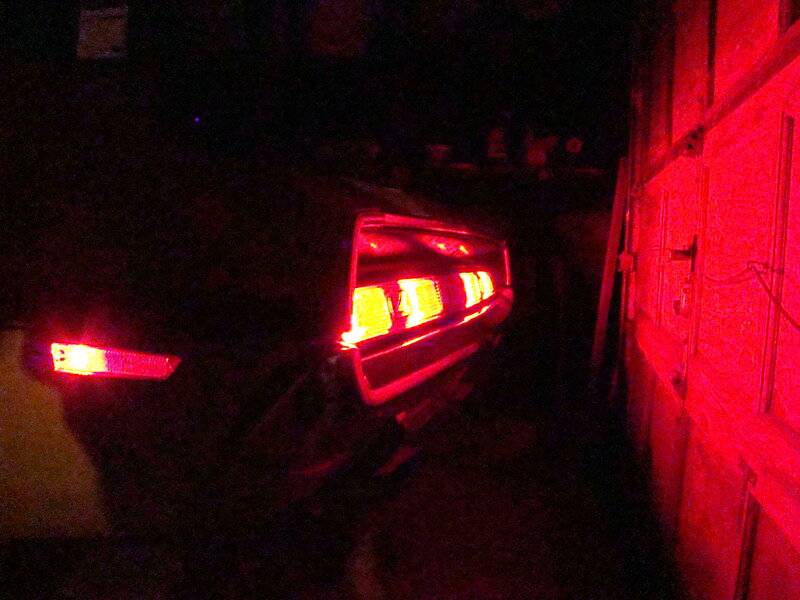

Ok, this is on my E not my B, but you will get the idea. Swapped out all my 1157/1156 bulbs. I will get to the side markers one of these days. So many MOPARS out there w weak lights, This was quick and easy. Way brighter ! A before and after shot tells the tale...

Did you have to do anything with the turn signal flasher ?

Darter6 / conv67bdere - at most my signals are flashing a percent or two higher - I see no need to replace the flasher. Thought it would need it but she's good as is
