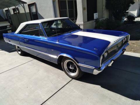

My son didn't realize the 67 Coronet R/T had left hand threads on the driver side and broke 2. Have been looking for replacements and have had no luck. Anyone have any ideas?
