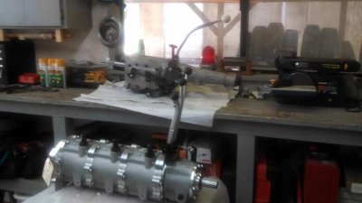

My Lenco ST1200 for the black Charger showed up today. The face plated aluminum a-833 is for my red car. Needless to say I am very happy to finally move forward on this project. UPS lost the Lenco for two weeks after I waited on it's production for about 6 months. I guess good things come to those that wait. Lenco ST1200 vs NP a-833 with shifter.jpg
Nice that is a wild looking trans . Got anymore info on it never heard of it?
Lenco, all the Pro Stock cars use to run them back in the 70's and 80's. They are bullet proof and can handle a lot of power.

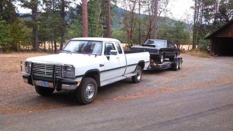

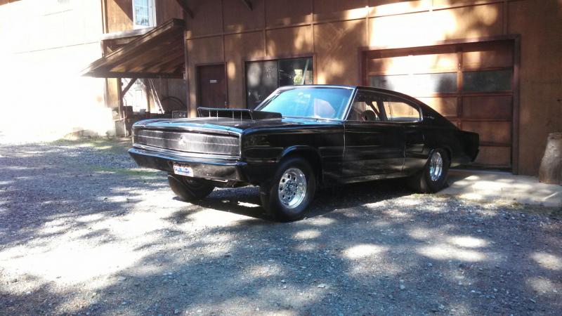

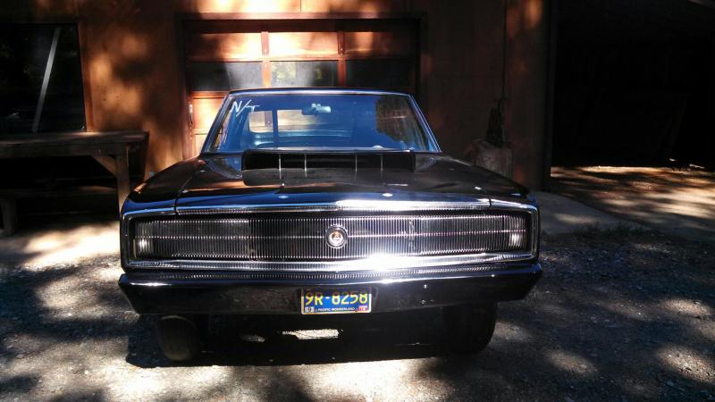

You have a picture of the car it's going in?
Thanks guys. It is going in the black/black '66 that we picked up in Washington. Wheels up pick was from prior owner. We are going to throw another 200 hp of motor at it and try to be cannon fodder for some of the NMCA West races...if they allow a planetary manual transmission.

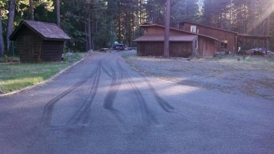

Looks like it was being shifted without using the clutch?
Yes that is correct. The clutch is used to get off of the line and then you just pull levers to up-shift. When the lever is pulled it makes that section 1:1 therefore only utilizing the ratios of the un-shifted sections. Each section is essentially an automatic transmission planetary with a manually operated wet clutch. The cool thing is that you can tune each section's clutch setup to soften or firm up the shift. It will be a big learning curve for me! I really enjoy an h-pattern 4-speed but parts breakage has become cost prohibitive. It's not like you can walk into a dealership and order more 18 spline parts anymore.
