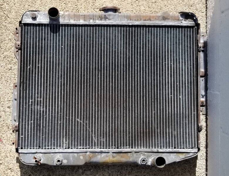

'68 Sport Satellite/Road Runner clone, 440/6, 727. The radiator that came in this car when I purchased it, from what I've researched, is not the most common setup. By that I mean the radiator inlet is on the upper DRIVER side and the outlet is on the lower PASSENGER side. (see attached radiator photo for reference) Meaning, the current water pump inlet is also on the passenger side, so switching to the more common driver side radiator outlet is not much of an option at this point. It DOES also have trans cooler hookups for the 727. After having some cooling issues I took a peak under the cap and while the coolant wasn't muddy, it definitely was dirty, but even worse 90% of the tubes I could see were practically plugged up. So, I removed the radiator last fall and took it to a radiator shop to be hot tanked, rodded, repaired, etc. Unfortunately for me, the shop said after well over a month of having it, that the radiator couldn't be repaired because there was too much damage to the tanks. Just as much, it appeared that it had been repaired previously, albeit rather poorly. At less point I was already in the hole with them only to find out that my radiator is not repairable. Their efforts to sell me a new, factory correct looking radiator for close to $1,200 was quickly shot down by me even after telling them several times the look wasn't a major concern. Heck, I can put at least 2 or 3 new ones in for that price. I realize that the factory radiator would've been my best option, and I tried to keep it that way. However, my question is, now that I know that the factory one isn't going to work I have have to do a full replacement as opposed to a repair, what would be my beat option? The car is obviously not original so please keep in mind I'm more concerned with function over form. Just as much, I would ideally like to add a fan shroud as it got hot rather quickly when sitting idle. For the record too, it has a 7-blade clutchless fan. Any and all help would be appreciated!

CC has a radiator that matches the one pictured. PM sent.

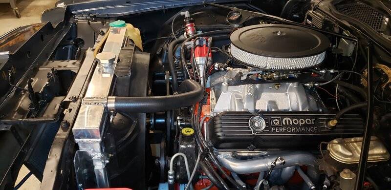

My rad is the same configuration as yours. Bought a Champion rad for around $200 (I have a dyno tested 440 500hp and no cooling issues). You'll need to find a late model shroud like that came on my Cordoba. Alternative is to get a aftermarket aluminum shroud. You can get a slim clutch for the fan if space is a concern but I don't think you'll have any issues. Its like a puzzle.

Your's looks like a 26" unit core width. If yes, our MOP750A is the direct fit replacement and #2785435 is the shroud you want to get.

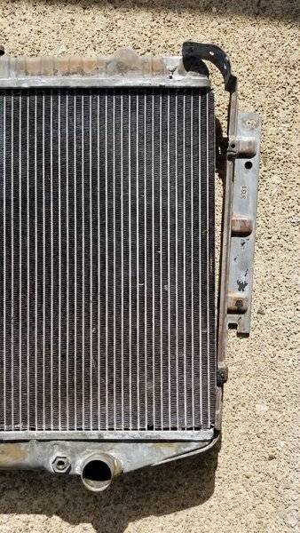

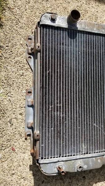

Below are pictures for referencing the overall style as well as the specific mounting areas, hose/fitting areas/styles, etc.
View attachment 1109809 View attachment 1109810 View attachment 1109811
That sure looks like our MOP750A except we don't have that top LH tank plug in ours. I wonder when that was used?
66-74 A,B,C, E Body 17x26 Auto Aluminum Performance Radiator | Cold Case Aluminum Performance Radiators (coldcaseradiators.com)
I can't promise the top mounting holes are going to line up perfect. If you look closely at the side mounting brackets, they are slightly different. We merged several part numbers to make this particular model of ours to keep costs down for us and for the customer. The shroud will mount although not like the original did. You'll have to drill 2 or 4 holes in the radiator brackets for a clean fit.
