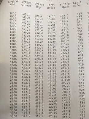

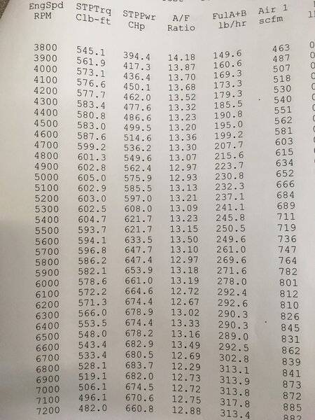

Hemirunner
448 cubic inch wedge
Factory forged crankshaft
Molnar H-beam rods
Icon flat top forged pistons
10.5 Static CR
Trick Flow 240 Heads
1.5 rockers
3400 lb street/strip car
4.10 rear gear
Target 650hp
Peak rpm at 6800rpm
What cam?
What intake?
What carb?
Molnar H-beam rods
10.5 Static CR
1.5 rockers
4.10 rear gear
Target 650hp
Peak rpm at 6800rpm
What cam?
What intake?
What carb?
