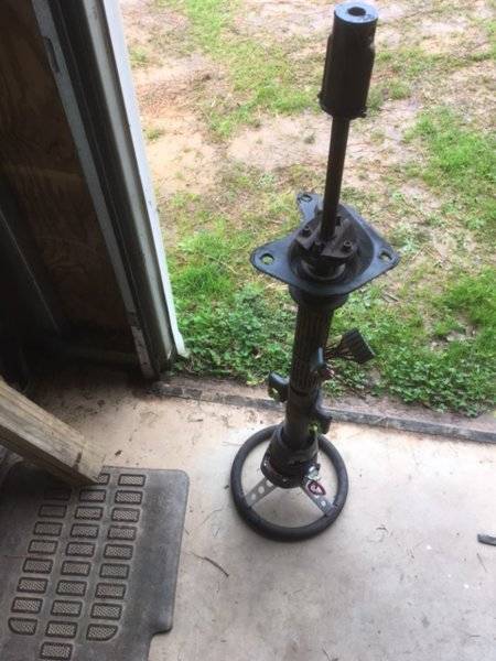

About to reinstall just the steering shaft in my car. I stripped the column down to just the shaft to save weight. Want to see inexpensive & simple ways to safely mount my steel shaft back in. It's a break-away column.
View attachment 532250 View attachment 532251 About to reinstall just the steering shaft in my car. I stripped the column down to just the shaft to save weight. Want to see inexpensive & simple ways to safely mount my steel shaft back in. It's a break-away column.

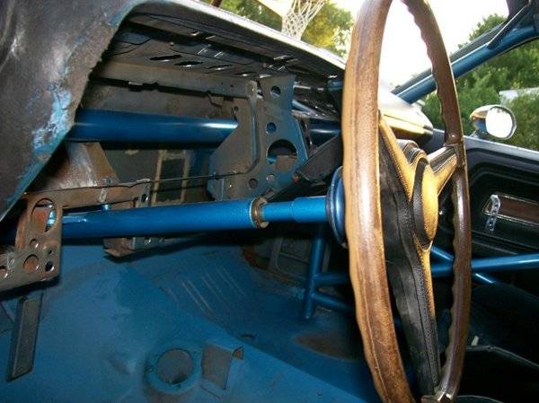

We made a tubular column in my car & adapted it to the factory (now removable) steering wheel & adapted it to the rack up front. It mounts in all of the factory mounting points.
The column pictured above is a good answer, but needs some support. The dash-bar would be ideal to attach to. All the ones we've used would bent/flex at that small diameter, when under load.
There is plenty of support. You just have to look a little closer there is two tabs on either side of the column bolting it to the bottom of the dash. There is also (not seen) a bracket that is welded to the cross cage bar that the column goes thru as well as a block plate that was made that goes thru the firewall where the old factory column used to go thru as well.

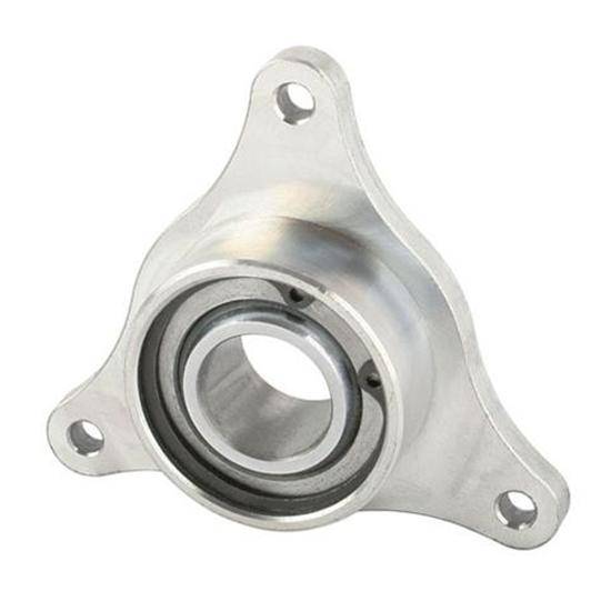

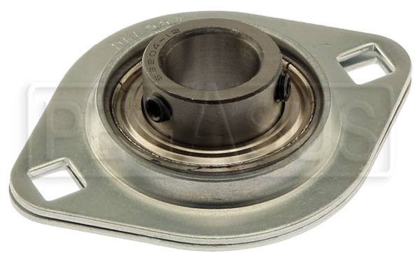

I was thinking of this from Speedway motors. The 3 bolt at the firewall & the 2 bolt bolted up to a piece of angle iron then to the Stock column mount.
