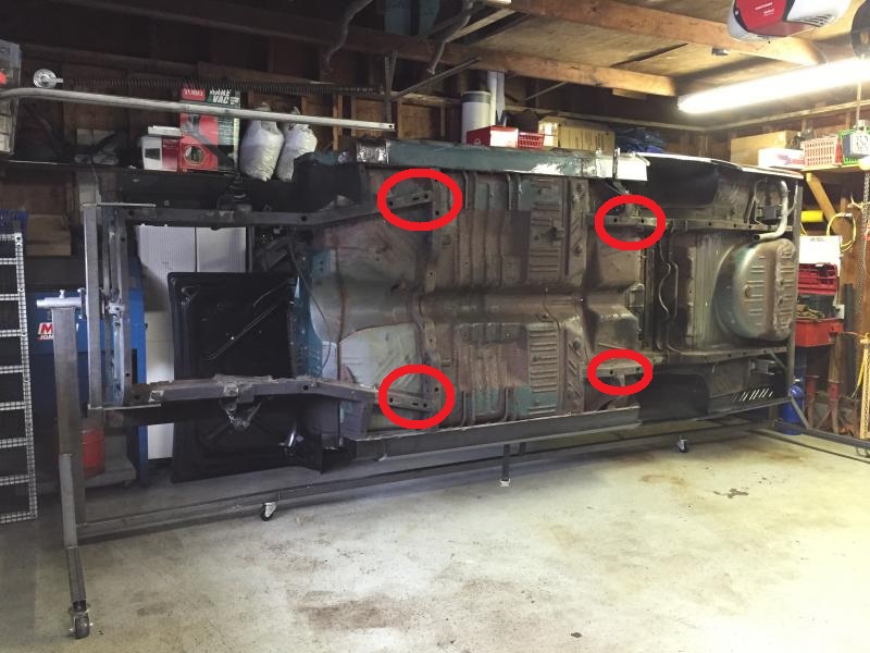

Another question, is there "correct" place and an "incorrect" place to jack and place jack stands on this body?
Jim
When jacking the entire rear I jack from the pumpkin. From the front, under the K-member. These uni-body cars can twist when jacking high from the side, so I like to use one at the back (on the frame) near the forward spring bushing and at the front (on the frame) behind the wheel. See red circles in pic.
Jack stands can go under the axle, and at the front where the K-member bolts to the frame on either side. Hope this makes sense.
Borrowed this pic.
Borrowed this pic.
Thanks for the answer and double thanks for the photo. That is the cleanest rotissorie I have ever seen. I will be making one of those. Crawling around on the floor is not in my vocabulary any more!
jim
