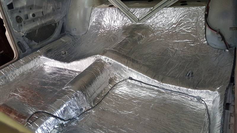

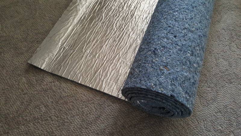

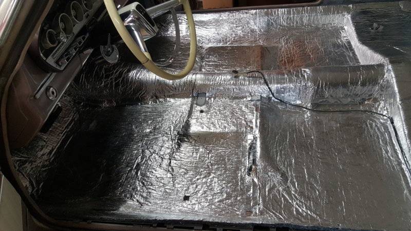

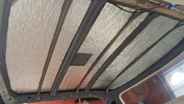

I ordered this from Home Depot. Made with recycled blue jeans. No itchy scratchy. Flame resistant. Fairly easy to work with. I used spray adhesive to install. Cuts with a good pair of scissors. Not expensive at all when compared to other alternatives on the market. I feel no heat from the roof or floor during a drive. Quite in the car too.

I ordered the 48" x 24' roll and still had some left over. There's no adhesive on either side. I'd cut it to fit, then use spray adhesive like 3M adhesive on the felt side and to the surface. Stick it in place. You could get by with just using adhesive around the edges in some places. I removed the jute backing on my carpet before I installed it. Wish I would have ordered the carpet without it. It was a bear to get off and too thick to leave it on there when using the Home Depot insulation.
My Home Depot didn't stock it and what insulation they did have I didn't like. Order it from the link that I posted and it's shipped right to your door.

Nice, really clean install!
A bit late now, but personally, I would have installed it, foil-side down so the foil would block more of the heat from radiating into the thick padding. Not sure how much, or if, it would have made a difference, just my $0.02
