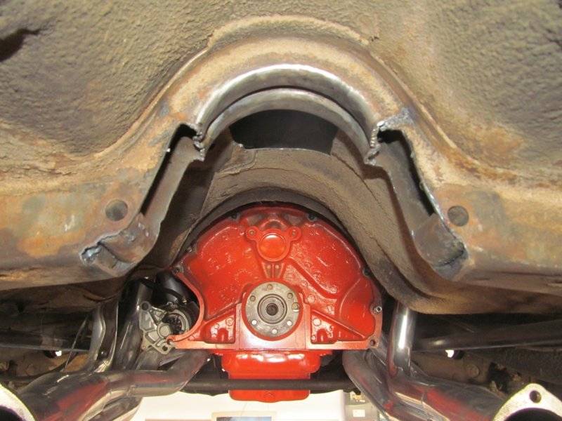

I have one in my Convertible. Got it back years ago when Keisler was selling the kit. The original "kit" angled the back of the trans down to clear the T-Bar crossmember. That did not work for me as the headers hit the suspension. Modified to rise trans in tunnel as below.
To install the trans with the output at the correct stock location, the T-Bar crossmember needs to be cut to widen it. he shifter comes straight off the top, so a hole for the shifter needs to be cut in the top of the trans tunnel for the new shifter location. They did sell an offset shifter handle so the shifter comes through the center console in the correct position. It actually shifts pretty good. Another issue is the location of the speedometer cable connection that comes out right next to the T-bar crossmember, so the cable takes a fairly sharp bend.
I did box in the open part of the T-bar crossmember where it was cut as shown above. Note hole in tunnel floor for shifter.
