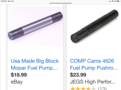

You should check your fuel pump and pushrod as well.

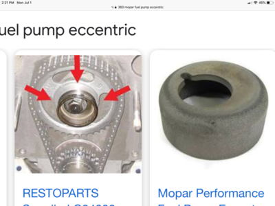

360 small block doesn’t have a fuel pump pushrod. It is run from an eccentric bolted to the front of the timing gear.
Call the auto parts store and ask for a fuel pump pushrod for a 1970’s 360 mopar and see what they tell ya.
Big blocks have the pushrod for fuel pump.
