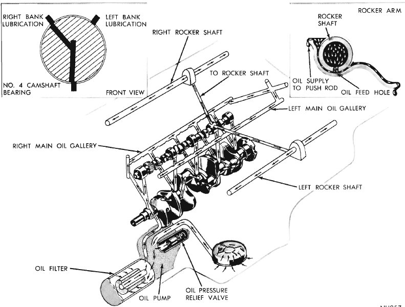

Not that it makes a difference but the motor is a 383, not a 440. I am 99% confident that the parts were properly cleaned and the machine shop did proper work. The shop has built dozens of similar motors with no problems. I will have to dig out the receipt on the break in oil, the machine shop gave it to me when I picked up my motor. Down below is a diagram of the oil galley passages. Even if 66 had an odd ball cam bearing it would not affect the lifters. I do no believe a lifter galley plug has been left out for three reasons, my engine builder has never left one out, I would have no or low oil pressure, and the driver side bank would be more likely to have issues being the last place to get oil. Here is the plan:
I am going to pull the rocker shaft and try to pull the lifter that is the biggest problem without pulling the intake. If I see any sign of a cam lobe going flat, I will dig in further. I am going to take apart, clean, and try to pump up the lifter to make sure it is good. I will bleed it off before I re-install the lifter and rocker shaft. I will then check to see if I have a bent or bad rocker arm. If the problem goes away, I will throw the valve cover back on with the same gasket and fire it up. If the rocker stays quiet, I will change the valve cover gasket. If the problem returns after any period of time, I will be forced to remove the cam and lifters and warranty exchange for a new set. I'm hoping to find trash blocking oil from entering the lifter. If I find nothing wrong, a bad lifter would be my next guess. Since the other lifters are not rock solid but are not as sloppy as #2 exhaust, I am hoping an oil change and some idling will help them pump up. I will report back what I find.

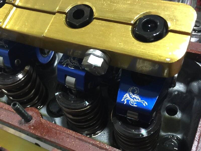

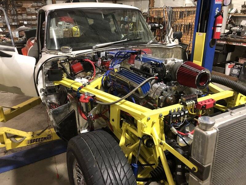

First off, I hope nobody kills me here because I do not have a Mopar, but I do have a relevant topic and we are all essentially car guys, right? Also, I realize this is an old thread so it may not even get read. I have a 1971 Jaguar E Type with a fuel injected small block 427 (General Motors). A few months ago, I started to notice lifter noise (Howards Roller Cam, hydraulic tie bar roller lifters and Scorpion roller rockers.) Shortly afterwards, the exhaust started sounding like I was hitting on 7 cylinders and felt sluggish. Same issue as in the thread above, rockers started getting loose, even after adjustment, the lifters seemed as though they were losing hydraulic pressure and would get loose right after adjustment. I replaced all the lifters with brand new Howards tie bar roller lifters ($$$) and all seemed well for a short time, but they too fell victim to the same issue as the first. A step back in time, I remember hitting a large cobblestone that fell off a truck and dented my oil pan and busted one of my mufflers. I did notice a drop in low rpm oil pressure afterwards but did not put two and two together until now. My theory is that I had reduced the distance between my oil sump and the bottom of the pan and restricted the oil flow at lower (idling) rpm. That incidentally is where the pressure drop is the most pronounced on my gauge. After I pull out and the revs build, the issue seems to dissipate some and the lifters pump up (or so it seems) but sitting at a traffic light and pulling out it gets worse. This seems to be the most logical issue causing this and I'm going to pull my pan and replace it and a new pump while I'm in there hoping to solve this. Two sets of lifters cannot be bad. Any thoughts? BTW: The cam sheet for Howards cams and lifters states "do not soak the lifters prior to installation."
