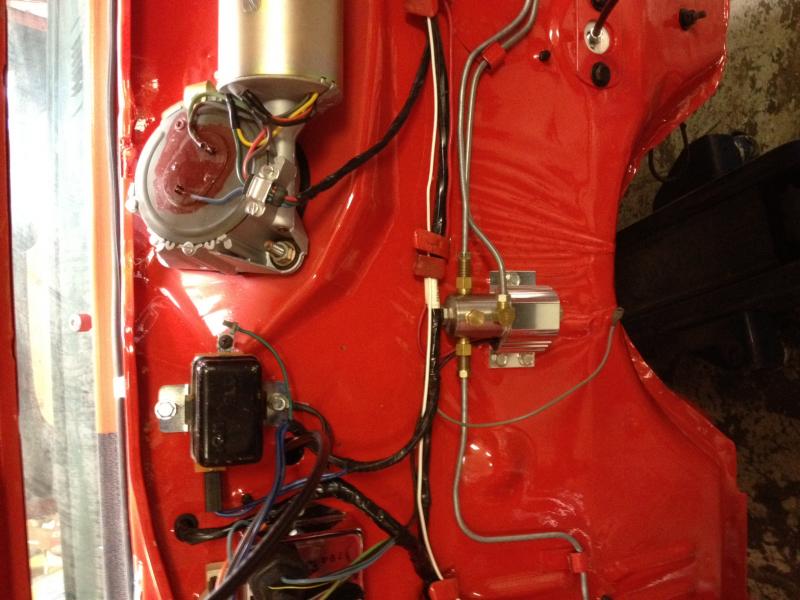

Here's what I did. The plumbing arranegement is that I use the solenoid as a tee for the front brakes. I ran a Parallel line to the left wheel and plugged one port on the metering valve. I have this setup working on my 66 bel with no problems. Also the location of the solenoid is neatly hidden. Use the instructions for your brake system type. One note. If you have an auto tranny you may want to use the solenoid to lock out the rear brakes so you have some modulation. In that case the valve location will be different
Forgot pic
