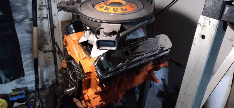

Just about have the 400/trans ready to go in the 71. Out of a 78 N.Yorker, 50k miles. Bone stock other than headers, intake and carb (for now). Waiting for my oil slinger...
