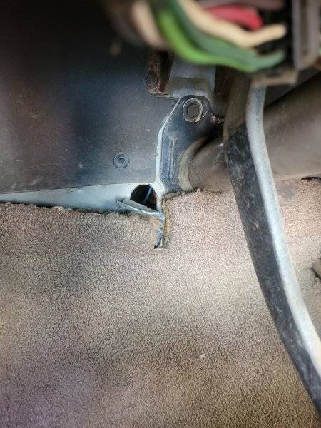

Just received my TKX package from SST for my 64 Polara. Currently my car has an automatic transmission. I'd be interested to see a photo or two where the clutch linkage rod passes through the firewall - either a factory setup or ideally, anyone else who has done this conversion. My install will have a complete hydraulic clutch system. Any supplied dimensions would be a bonus. Thanks, Charlie.
Look for the big oval plug.
It will use the same hole that the auto transmission shift cables go through. It is between the steering column and the fender apron
I did look for this plug, but I'm not seeing any. There is a raised boss on the firewall that measures approx. 1" wide by 2" in depth / length. Would this be the location?
