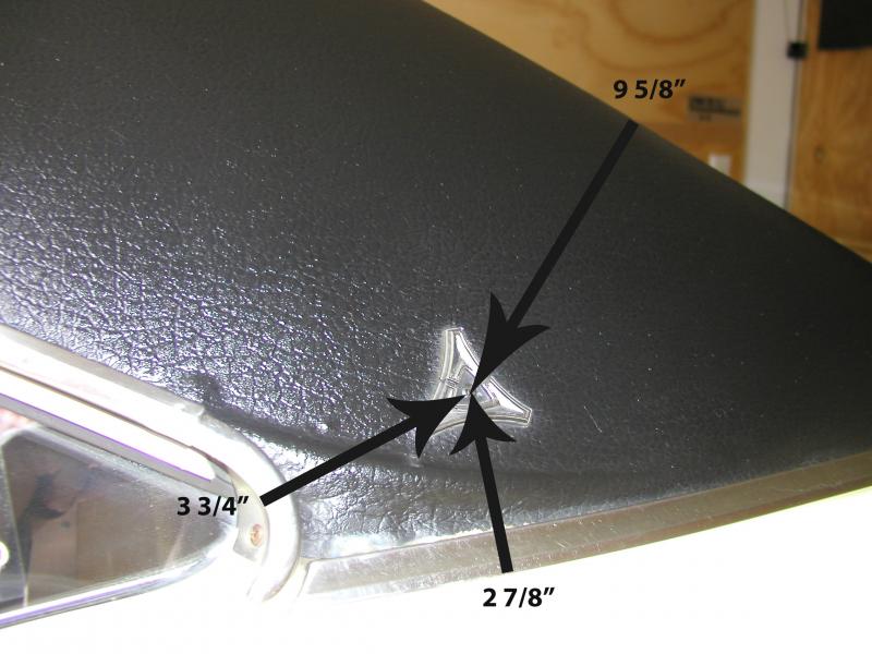

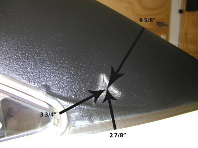

Location Pentastar 1969 coronet R/T?
Hello.
The Pentastar is the five sided emblem behind the front wheel on the passenger's side.
The three pronged Dodge emblem on the "C" pillar is called a Fraztog.
Fratzog: Dodge's logo from September 1962 through 1981 was a fractured deltoid composed of three arrowhead shapes forming a three-pointed star. The logo first appeared on the 1962 Polara 500 and the mid-year 1962 Custom 880. One of its designers came up with the meaningless name Fratzog for the logo, which ultimately stuck. As the Dodge Division's logo, Fratzog was incorporated in various badges and emblems on Dodge vehicles. It was also integrated into the design of such parts as steering wheel center hubs and road wheel covers.
So... do you want the location of the C pillar emblem or the fender emblem?
Maybe this will help you.
