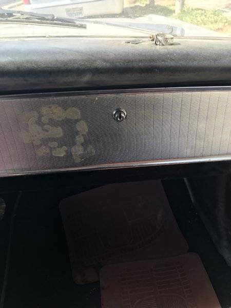

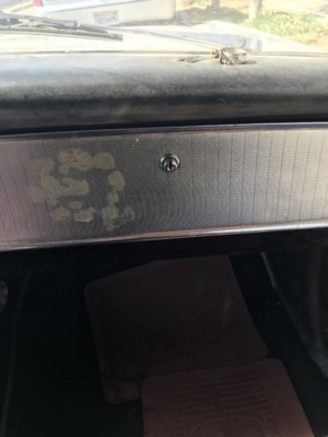

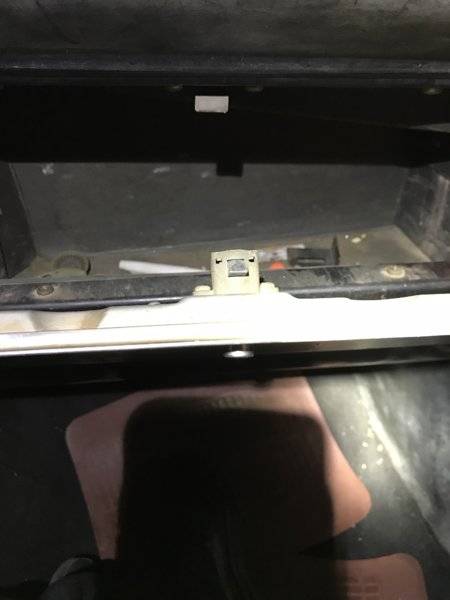

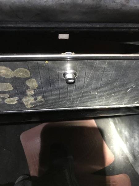

Anyone have any experience breaking into a locked glove box? I’ve never had the key. Tried going in through the rear hoping that the liner wasn’t there, but it is. Should I just admit defeat and go to a locksmith? Should I rip off that liner and replace it later?

Lock Pick set worked!
