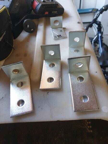

My '66 Satellite has buckets that tilt forward but have no locking method (as do all '66 models I assume). Coupled with lap belts and no headrests I'm thinking this would be pretty bad in the event of a crash.
Anyway, I'm on a mission to try to improve things. I've locked the seat backs with a few brackets from the hardware store - I removed the nut that the seat back rests on, slid them over the thread and then bolted them on. I'm going to get some headrests from the wreckers next week and get them re-covered to match the seats - there's enough meat in the top rail of the seat to drill into and I'll fabricate a support halfway down the seat back. Then I have to investigate some 3 point seatbelts although I'm not keen on removing the headlining to install an anchor point.
Access to the rear seats is tight now, but ok if I slide the seat forward. Not ideal but will do for now.
