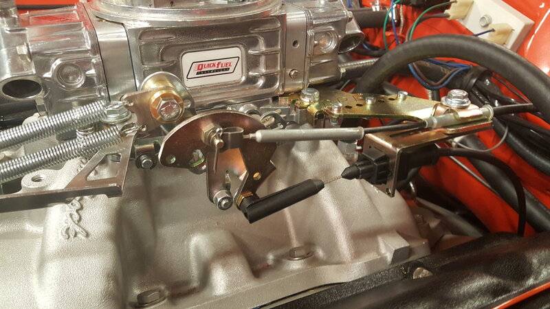

I've used the Loc
kar cable on a few transmissions and like said above the outer portion is long has to be shortened. Besides that, it;s easy to adjust, and works good. I just put one on my 68 RR build. RUFFCUT
It's so easy it's not even funny. Cut the cable outer housing to the length you want, route the inner cable. Put something heavy on the gas peddle to keep it a WOT, pull the inner cable enough to max out the kickdown lever and tighten the set screw. Trim the excess cable.....DONE... they trick is having the shorter kickdown lever to keep it as close to a 1:1 ratio as possible..
If the kickdown lever ratio is too slow, you can just drill a new hole in the lever to increase the ratio.

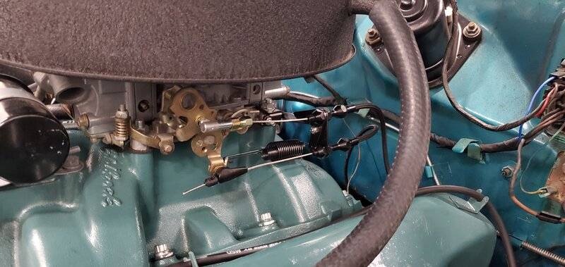

I have used the Lokar cable kickdown when space considerations prevented linkage (360 transplant into a 1988 Dakota). I found it hard to adjust to get proper action. The secret here is that the carb linkage and the kickdown lever work on a 1:1 ratio. That is, the attachment hole on the kick down lever must move through the same distance as the attachment hole on the carb linkage. This may necessitate drilling new holes at either place to achieve this. If your problem with original linkage is caused by increase height of aftermarket intake manifold, I think A&A Transmissions or Mancini has linkage kits to deal with this. After that, it is just a case of getting out your shop manual and setting linkage up as explained. I have helped out a few buddies who had shifting or kick down problems just by going through the factory adjustment sequence. I hope this helps.
