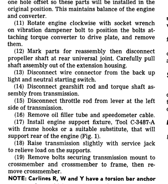

yep, it does have the removalable c-member. This is directly from the FSM

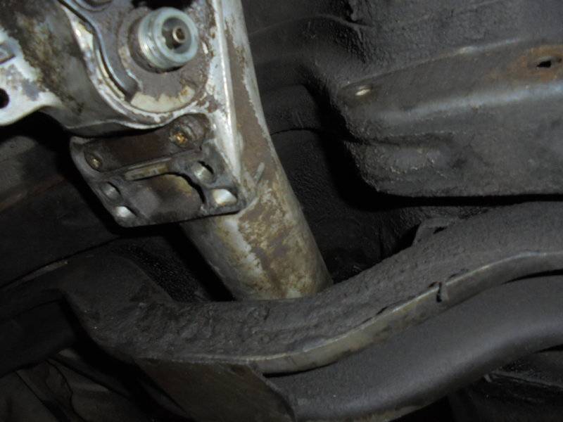

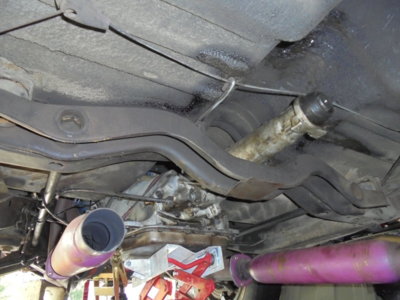

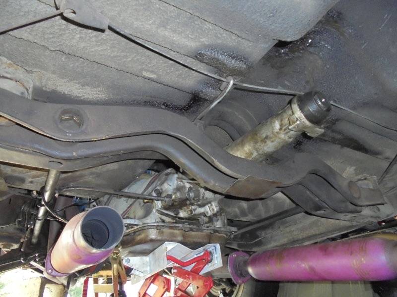

here it tis...I wanna cut that brace so bad I can taste it. How difficult are torsion bars to deal with? The last photo shows the mount brace removed. just to be clear.

do u have room enough if u unbolt trans and slide trans back then down and out with torq or with out ,
I have a 75 manual and they say after everything is disconnected a slight downward angle of the front of tranny will be the way to remove it. They do mention the torsion bar anchor crossmember which remains in place while tilting tranny front downward. It seems like R,W,S & X car lines have this anchor. Good luck getting it out.
Ok. I thought this may work but wanted to see it in writing before trying to tilt a 160lb trans and if it will in fact clear the motor...this will make my cheapy trans jack usless. will have to figure how to support a trans at that angle...it will be steep.
Don't forget to support rear of the engine and maybe it could be lifted a little to facilitate the front of tranny having more room to come out.
Thanks everybody! Unless torsion bars are easy to deal with...I'll try tilting the front down. Any suggestions on how to do this safely?? I can see my trans jack spitting out from under the trans or falling over.
I've done this a few times recently on my 74 charger. without removing the torsion bar cross member, you will need to secure the torque converter in it's place and support the engine before removing the trans bell housing bolts and starter. you will have to tilt the front of the trans down and slide it forward. it will work just go slow and support the trans . use gravity as a tool . drain the fluid and keep the area dry. I used an old blanket to drop the trans on and used it to slide it out from under the car.
The book also mentions keeping the Torque converter on the tranny with a c clamp, but I can't see the purpose of that in the removal process. I could see it in installation of tranny. Maybe a more educated response from someone who has removed tranny's in this car line can chime in and say if that is really necessary to keep converter on in removal.
