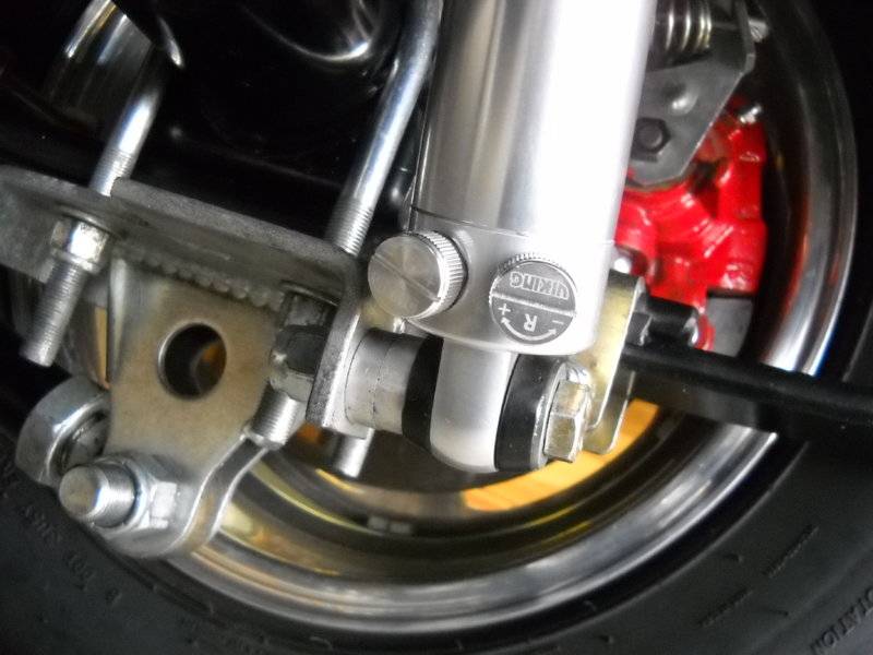

Viking double adjustable shocks from James at PST. They work great and are super easy to set compression and rebound without removing shocks...

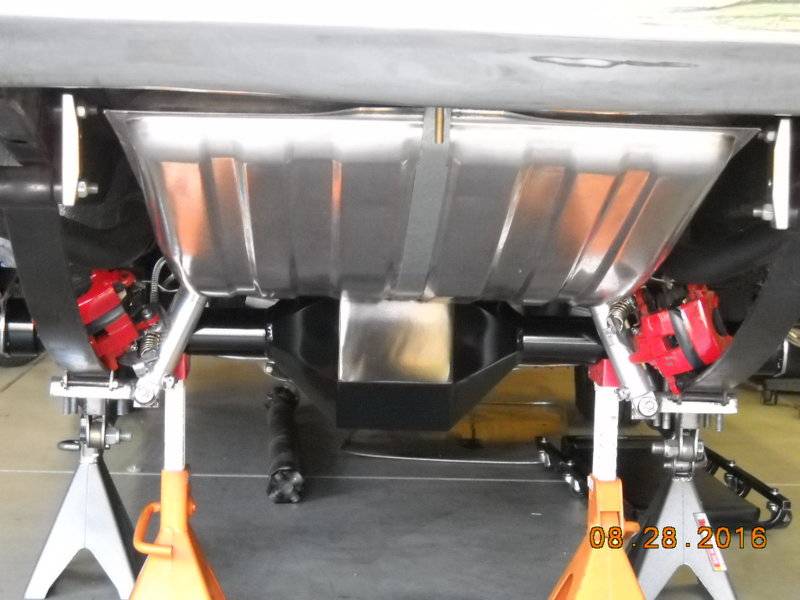

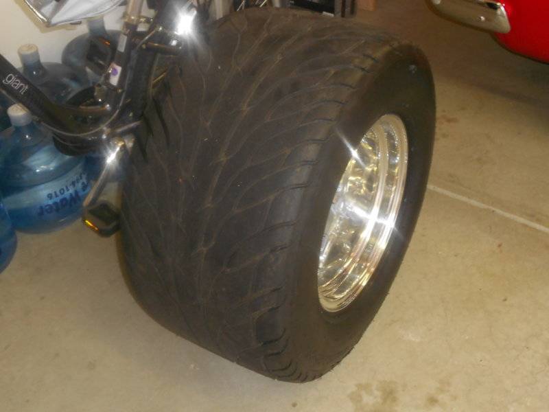

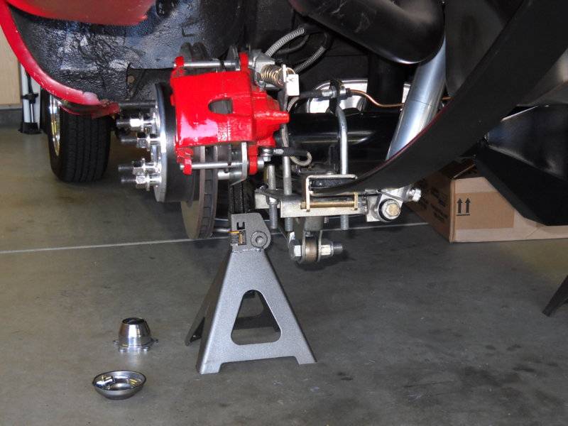

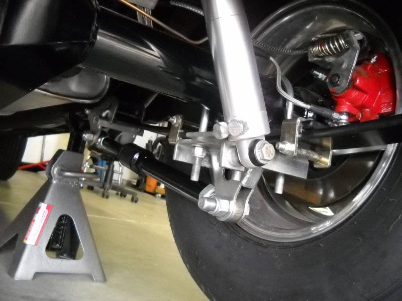

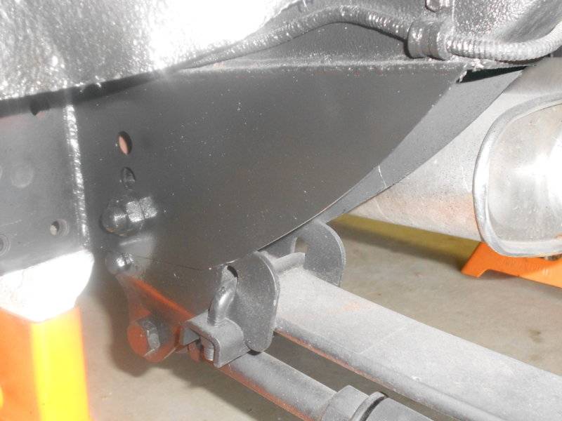

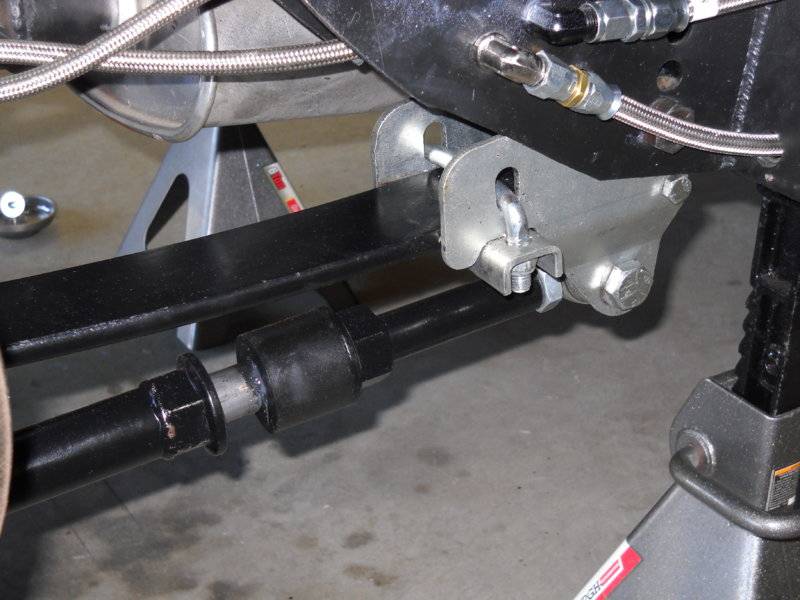

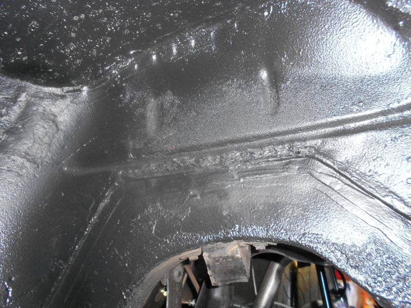

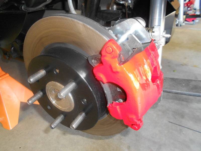

Sure. 63 Plymouth Fury Convertible
*Narrowed Moser fabbed 8.75" rear-end, axles and disc brake kit, Detroit Eaton Truetrac limited slip, 3.91 Yukon gears.
* Calvert mono leaf springs
* Competition Engineering traction bars
* Viking double adjustable shocks
* Magnum Force spring relocation kit and billet rear shackles (3" in, even with frame)
* Mini tubbed, 15"X12" Wheels 29"X15" M/T radial tires
Street car, driven most days...

Street car, driven most days...View attachment 616076 View attachment 616078 View attachment 616082 View attachment 616085 View attachment 616086 View attachment 616092 View attachment 616095
that is a great setup one question with the relocation setup is it for super stock springs.
is that e brake setup. never seen that before nice job.
Sure. It's certainly not the cheapest kit but I liked the billet shackles and the adjustability for ride height.
Kit is from Moser. 1981 Cadillac El Dorado calipers & pads. Don't know if e-brake lever is stock for that application or something he fabs...
