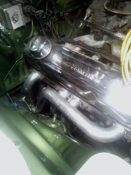

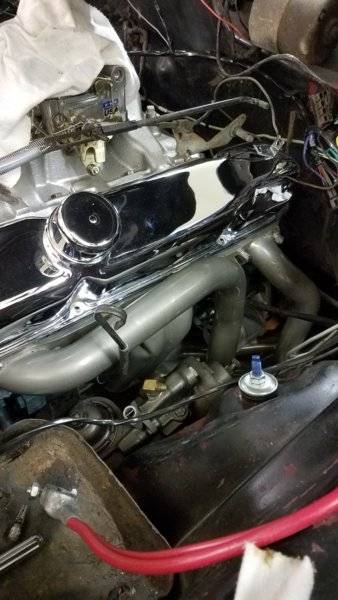

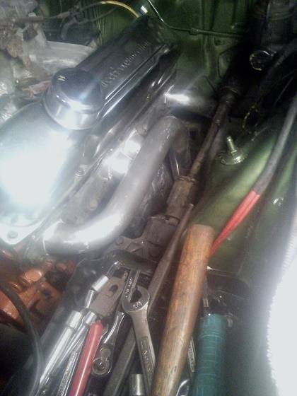

I replaced my headers last summer. I didn't use ramps, but I had 4x8 blocks under the front wheels. The passenger side was a piece of cake. The driver's side was pretty easy, but I needed about 6" more clearance to slide the header out (383 4 speed). Luckily my garage floor is brick, so I just pulled a few bricks up.
These are 1 7/8 TTIs and had to remove torsion bars on both sides,had to go up from the bottom,glad I have a lift.these are on my 66 Belvedere 383.
all I had to do was pull the motor mount bolt and jack each side of the engine up as I did each side. And the starter when I did the driver;s side. Didn't have to touch the torsion bars or clutch linkage. Mine are Flowtechs, manual steering.

Update: Had no issues at all getting the headers in from underneath. Didn't even need to jack the engine up, they slipped right in.
