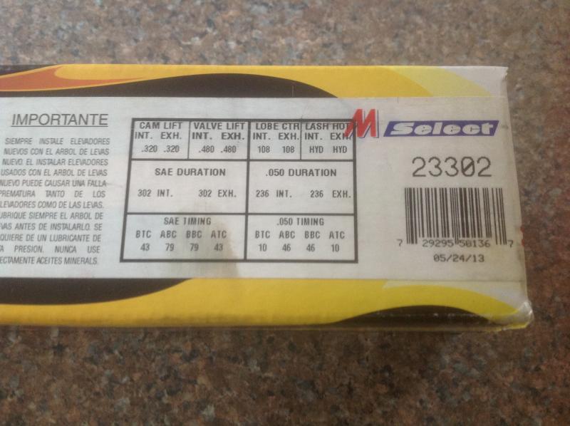

Here's what I have for specs on the cam I put in a 383 (not440) with an edelbrock tm6 (not the rpm) and holley double pumper 650. the motor is not stock either. But I didn't want that big "funny car" idle either.
The po said the motor had a very aggressive cam in and it didn't run well at all. I found out that it had other issues. But since tracking those down and fixing, idles well not too Lopey but runs well.. And it has that initial get up and go.
I know not your exact setup but I thought it might get you some numbers to think about. I'm pretty happy with the choice. I'm not too sure if you can get both the way he wants?? I'm thinking there will be some give and take on each and by the time he's done he should have listened to you right from the start..
Good luck! Hope it helps a little
