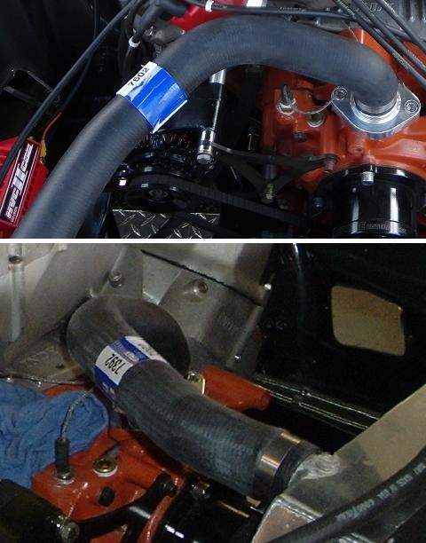

I have a 64 with a later model K member. I used a Napa 7392 with my top tank radiator. Switched to a Napa 7602 for my side tank radiator. The 7602 pictures look like it touches the distributor but it doesn't. Both fit fine.
