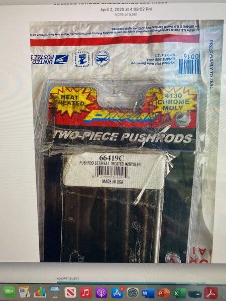

SP had 159K miles on the clock when we did the Resto. The Rockers were really sloppy. So, we decided to put on Roller Rockers as a replacement. Used Profom 66868 Rockers, and then the Proform 66416C Push rods. Broke in the Cam. No worries. Took car out for two around the block test drives, no worries. Yesterday was a Very nice day in KC so decided to take her in for an inspection to get tags on her.
I noticed she was down on Power and was "smoking" on riders side exhaust. Took off the valve cover on that side and noticed one Rocker was out of place and the Push Rod was laying on the side. Fortunately, found the pieces. Has anyone else ever seen this?? Looks to me like it might well be a metal failure? Best, Brian

The pushrod cup insert failed (fractured). That type of failure can be attributed to material or machining process. 440'

Maybe its me, but does it look like there are voids between the cup and rod? Did they actually weld the cup to the rod? Where it fractured looks like a stress-fracture, but there should not be any high side-loads on this cup... is there? What does the bottom of the rocker look like? Could it be off-center and stressed the cup?

From the wear, it looks like the ball is possibly bigger than the cup.
