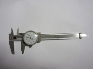

This is a 4" I spotted for cheap years ago. Feels solid, smooth action, Made in China.
When I open and close it the dial lands on zero half the time. Sometimes -.003. sometimes + .004.
All is fine with it except for use in measuring stuff.:rolleyes:
