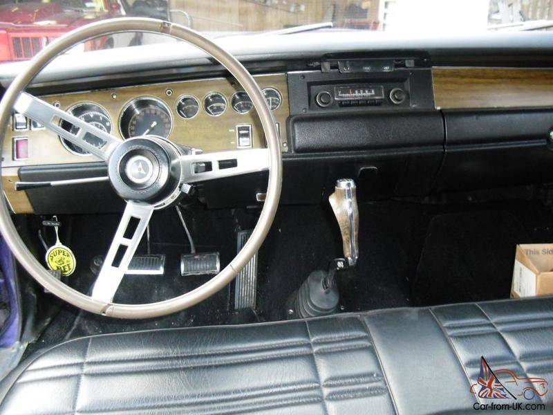

If it's a 4 speed car it will have the factory tunnel hole for a 4 speed. along with the linkages. should look like this when assembled..
