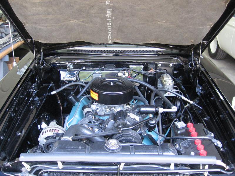

Here is another, 451, stock 346 heads, Iron intake,600 AFB, 484 purpleshaft. Auto with 3.73 gears.
TTI headers and full exhaust.
Owner wanted it to look like a stock 383 with air. Chassis dyno pulled 346HP at the wheels.Heads, intake and carb limited high rpm. Car ran high 12's but can drive anywhere in comfort like a new car.

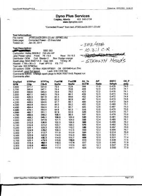

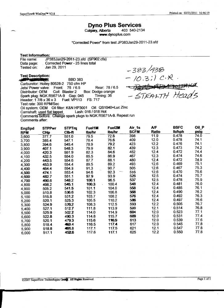

Deja vue here.... but we built a pump Gas "438" 383 block based combo, pretty much the same as you are looking at, for a Customer's '69 Road Roach 4 spd W/3.55's about 3 years ago.
He LOVES it !
Even with 28" Tall Tires on the 3.55's, it just PULLS HARD anywhere !
Stealth Heads
Flat Tappet Solid(used XS282 Comp)
stock 440 Forged Crank
527 HP @ 5400 rpm with 555 Ft/Lbs Torque
It was Dyno'd on Pump Gas(91 Octane), this particular run used VP113 for a test because he also has a Racecar and wanted to try it(use up some of last seasons old fuel)... didn't make dick for difference though.
