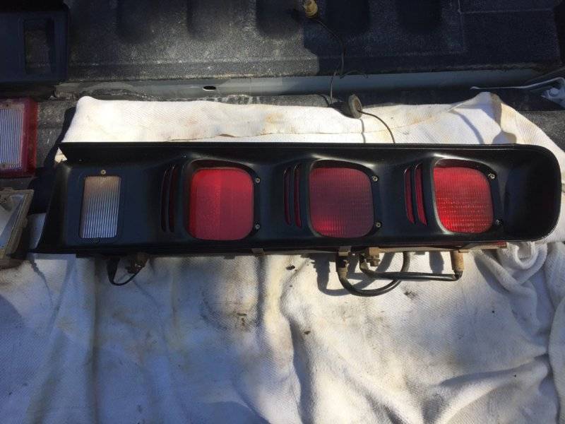

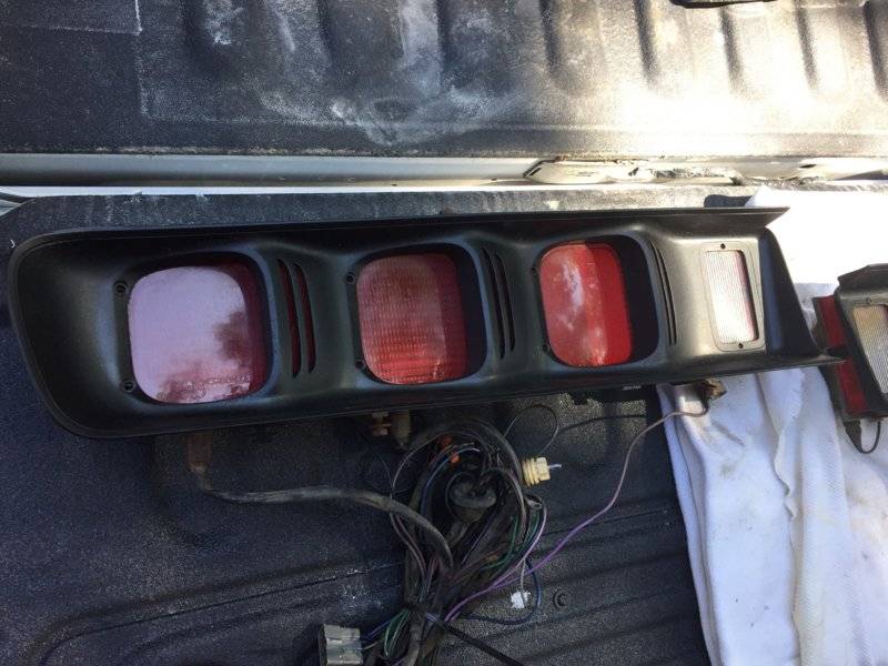

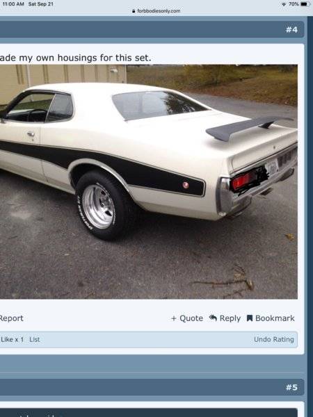

I made my own housings for this set.
if i could find a pair of lenses i could put another set together.
I made rectangular steel housings that the lenses fit in perfectly. I made them two inches deep, and divided them as needed to segregate the individual lights. The lens sets the position of the outer bezels. I drilled holes for the bulbs,and used fender shims to bolt the bulb sockets into the housings. I used silver paint and reflective flashing to help the bulbs reflect like the original housings. I used long screws with nuts and drilled through the housing and bolted the bezels and lenses to the housings. I also drilled the housings to bolt them into the bumper, using whatever size bolts, nuts and washers necessary to properly position the assemblies into the bumper. I ran a bead of silicone around the lens where it meets the housings to keep water out.

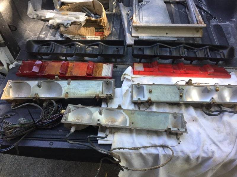

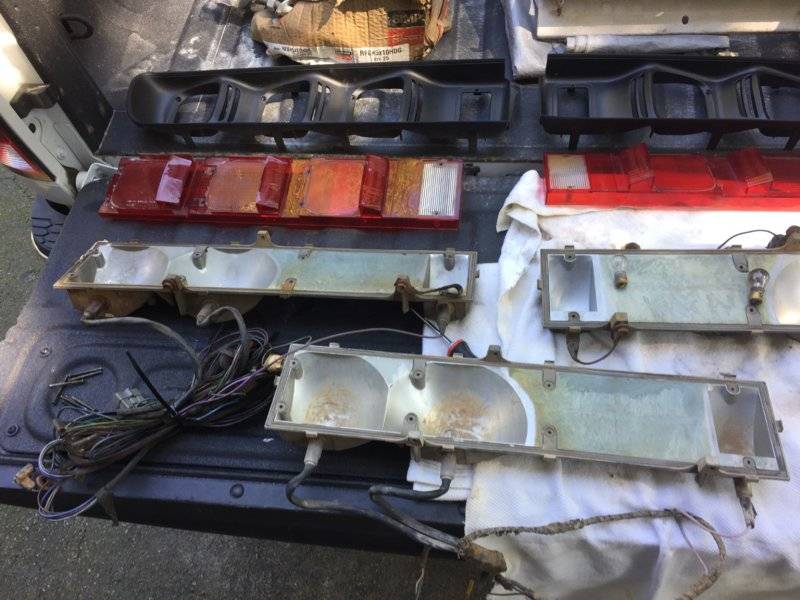

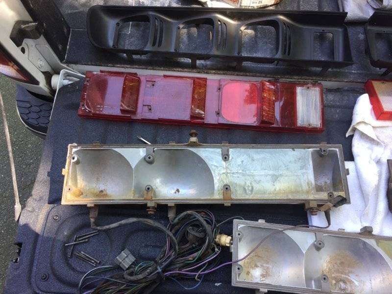

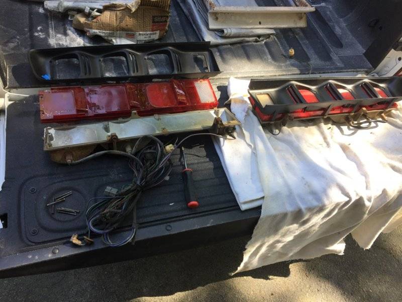

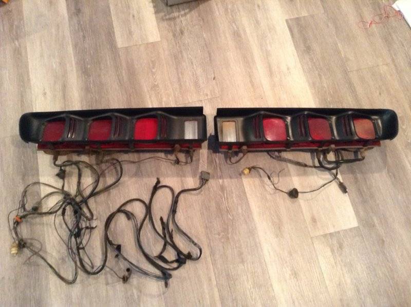

The Original poster disappeared and I’m considering parting this full set of taillights to get @Dreamcatcher some housings for his car. Conversation started Don. I know the lenses will sell fine on their own. Would anyone have any immediate interest in the bezels if I part this out for him? They are Very good condition.

Wouldn’t that look slick with the black Bezels?
