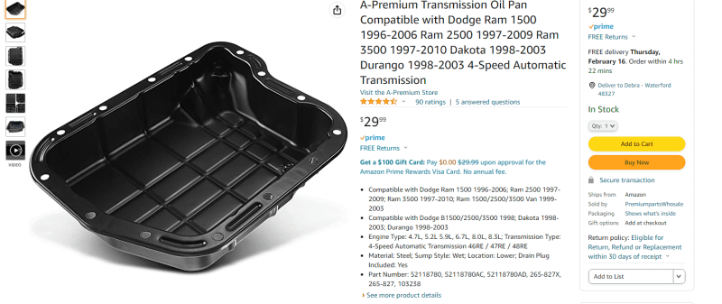

A standard Kit with Borg Warner or Raybestos frictions rebuild kit will easily do the job. Get a TF 2 shift kit (Summit is the cheapest). Make sure it has a 4 plate front drum. There's a few easy little tricks I can help you with as you build it. This combo will actually take well over 600hp with no issue. Probably built over 30 in the last few years.
Go here. Stuff is good,and inexpensive.
Trans Parts Online 727 727 Transmission Parts
for a deep pan, go here. They are nice with a drain plug.
