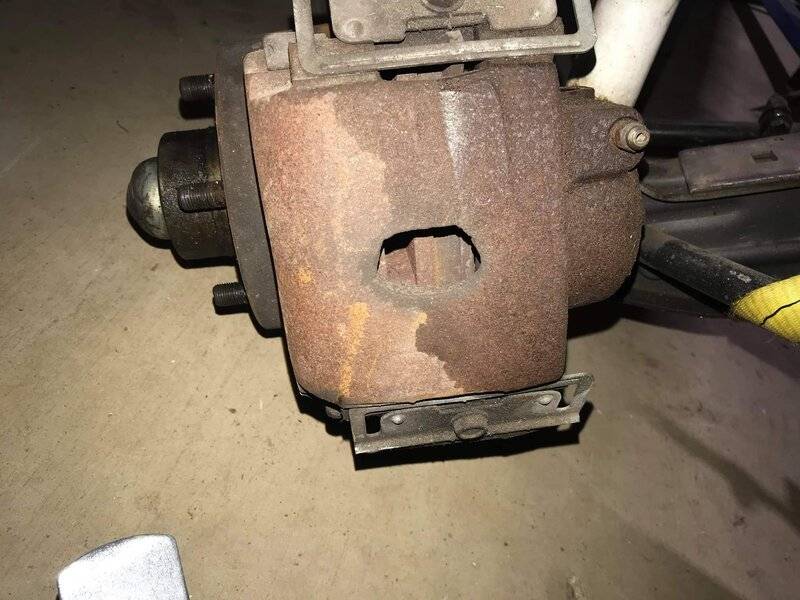

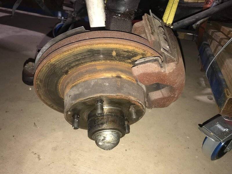

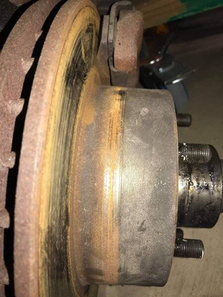

Brakes. the brakes i have on i believe arent standard, can someone tell me what they are from? It seems the rotor and caliper dont match up quite right as it rubs on the hub. Im planning to go disc on the rear aswell. Will the old ones be ok to use if i clean them up(sandblast, paint, new guts and pads) they seem ok on a quick visual, but is there any telling signs that a newbie wouldnt see? i was planning to go dr Diff on the rear but seems hes out of stock. maybe wilwood on the rear, but then the front should be changed to i guess.

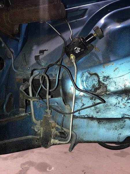

Do i require both brake valves if i get rid of the rear drums? one is adjustable and one has the switch in it.

I'd just clean up your front brakes, check the pads, new brake fluid and new rubber lines. I'd also keep the rear drums, just replace the cylinders.as they're probably leaking. You can get all the drum brake parts locally, no need to source from the US. I'm not sure how rear discs work with the factory tapered roller bearings. I always thought you had to switch to Green Bearings if you wanted discs on the rear so I kept the drums. The car stops great with front discs/rear drums so I'm happy.

The front brakes, i reckon i will have to change the rotors as they are rubbing on the calipers as you can see in the last picture. Would Valiants have the same pattern? maybe i can source rotors here to. I would like more room in the engine bay as the box is a very tight fit in there at the moment. I will be doing it all myself. Koni shocks i will check them out
