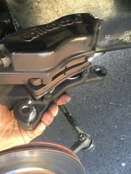

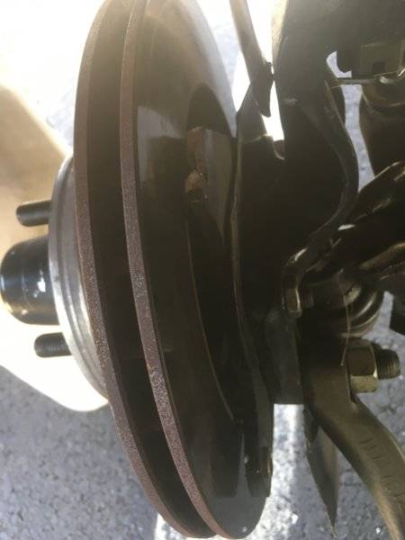

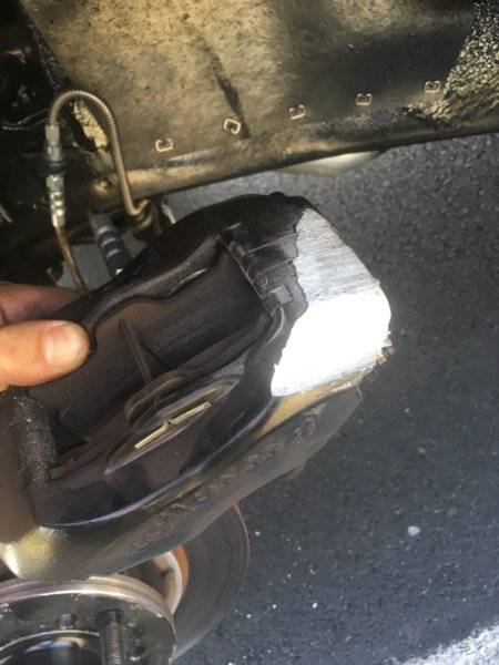

Hi All,
Had a bit of a scare yesterday when I had a serious brake failure. It looks like I lost a bolt from the caliper, the other side sheared off at the mount point from taking the load. The caliper then carved up the inside of the rim before jamming and locking the wheel.
I was lucky that it happened on the off ramp and not while doing 65 down the highway.
Needless to say I’m looking for a new brake kit, big but fits under 15” torque thrust. Ideally has a thick mounting bracket.
Love to get some advice / feedback from on what’s available.
Couple of pics from yesterday,

I'd call wilwood and ask why their bracket failed
Note to self, Use loc-tite next time! Glad there was no more damage then that.
looks like the problem was ether low grade bolts , and or over torqued , and they stretched
always use grade 8 bolts and locktite , it s not the brakes that were defective it was ether the installation or hardware

Bolts were grade 8, it is possible that they were over torqued. **** part is I checked all the suspension bolts before leaving on the road trip. Didn’t check the brake bolts, which was clearly f’ing stupid.

Personally I would stick with what you have. As some how the one bolt clearly backed out but unfortunately we will never know exactly why. But thankfully you and your car a safe with little damage.

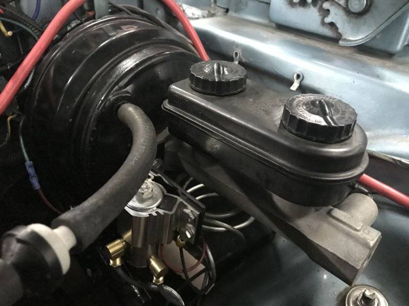

So I have the wilwood 140-11020 11” 4 pot kit, wilwood adjustable bias, factory booster and disc brake master cylinder.
I can get a replacement caliper. I’m looking into if I can get a replacement bracket from wilwood.
Surprisingly the rim looks ok, lots of Ali flaked heat fused on from the caliper grinding away. But other than that looks like a polish will clean it up.
