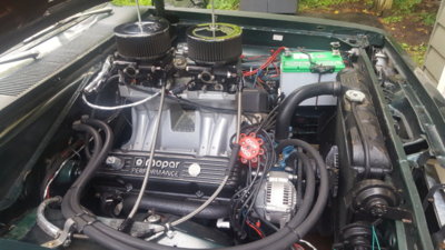

Ptfe, 6 an, one line from the regulator near the fuel tank to the inner fender.
The braided ptfe is the easiest line to work with, fittings go on very easy/quick, and it doesn't deteriorate over time.
Put heat stuff on line, but not near headers at all, and might not look it in pic but plenty of space between heater hoses.
Rubber line over the forward section slid down, was secured up higher at tb as it was close to hood. It was just there as a precaution as I had a bent a previous engine mount.
Psi gauge on tb.
