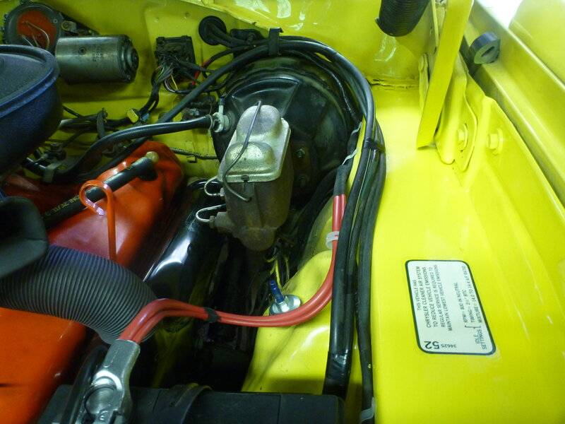

looking for firewall brake bracket pic please 68/70

no booster this is the long bracket

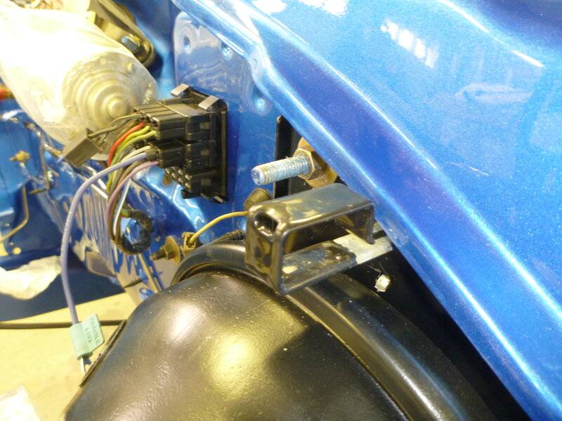

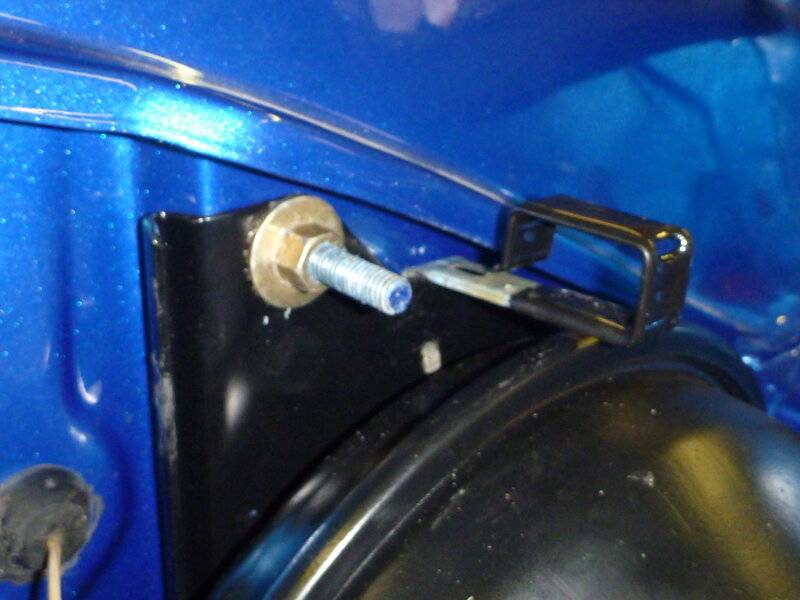

I the bracket shown above in the correct orientation for a manual brake car as well? Seems that I have always seen that bracket bent downward when installed on a manual brake car.
If my memory serves me correctly, which isn't always the case these days, I believe there is a short and a long bracket for the wires at that location. Long with booster and possibly short without. I don't know, both of mine have boosters..

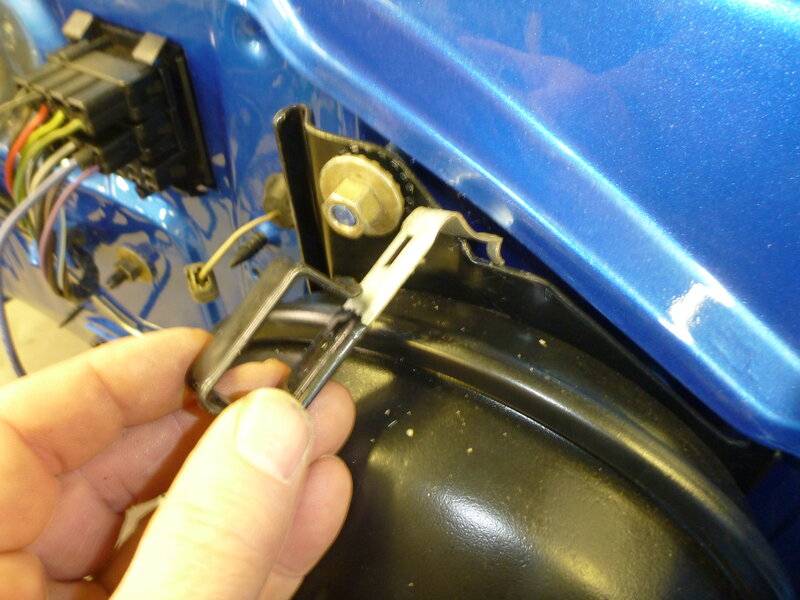

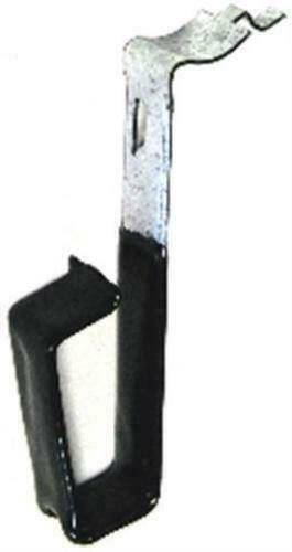

I thought short was for booster and long for manual brakes.
Pretty sure I bought the correct one for my car, I'll have to look at the Bird tomorrow to make sure they are both the same. I know the Bird's is OE.
did you have time to look?
I did actually. The repro on the Bee is just shy of 3" long and straightening out the Birds bent up thing, the most I dared so as not to crack it, it's about 2 7/8" long. Scoured through my parts manuals for '68,'69 and '70 and I can't find it referenced anywhere. I do remember reading "short and long" though when researching, I just don't remember proof positive which is which. In my mind a short one would make more sense on manual brakes, with no booster to get up and over, but I didn't design these things! LOL
how I was looking at it ,it just hung down. I did not realized it was to bend up. Now I see why the short would go with no booster.
