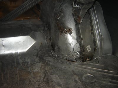

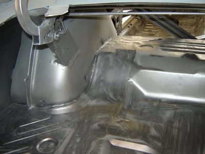

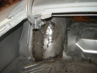

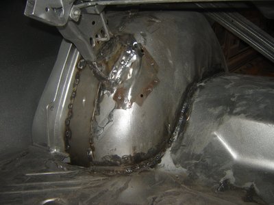

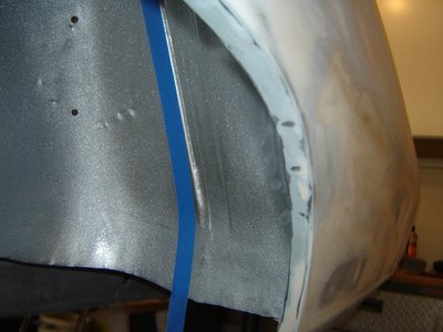

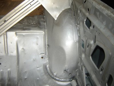

I've done mini tubs on a couple of b-body cars. It does take some surgery when doing your own 3'' strip but not to complicated.I can share my photos but I am a jump in head first fabricator.LOL so I don't have any measurements with the pics. But always willing to help with questions.
DSC01694.JPG DSC01695.JPG DSC01696.JPG DSC01697.JPG DSC01698.JPG DSC01699.JPG DSC01700.JPG DSC01713.JPG DSC01714.JPG DSC01715.JPG

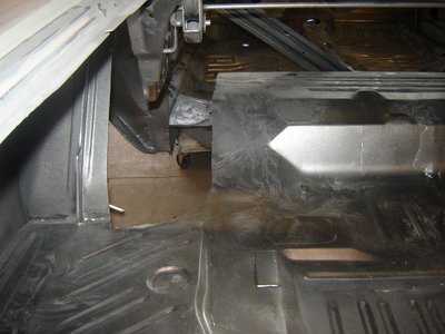

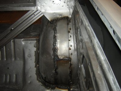

Here are the rest of the pics I have. This was the first time I had done it. Not as clean as some of the Mini tubs I've seen on here but hopefully it
Helps.
Thanks,Joe

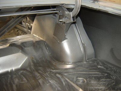

I'm back! I used the US Car Tool kit and rolled a step in the piece to give it a nice flat surface.
Very Clean!! I would have rather done the US car tool kit as well. It wasn't available at the time.The next one I do I will use there kit.I like your results.

Couple questions ...
There is a stamped dimple around the inner tub - did you move that whole piece over or just cut it out?
Did you trim the lip off the frame rails and weld the tubs to the side of the frame rails?
How wide is the step you rolled?
It seems to me that with the car intact it would be a bitch to get at all the spot welds to remove that inner tub.
Yes just cut them out.
Yes trimmed the lip. About 3/8-1/2 lip. If I remember right there's a rolled lip next to where the 2 halves come together, that's where I put my splice.
Depends if you want to save the original inner tub or not. Might be easier to scrap the OEM tub and buy a new one.
