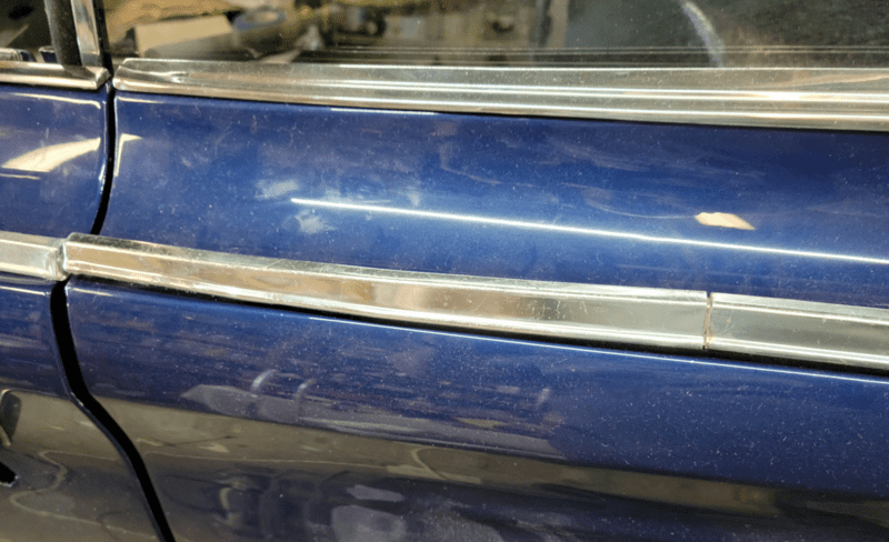

Hey all,
I am getting down to the final stages of reassembly of my 66. The pinchweld trim molding is very tired... scratched, dented. Compared to the new paint job and polished stainless, it looks bad. The pictures show AFTER buffing.
I can find no source for aftermarket trim and with the original being chromed aluminum (at least I think it's chrome over aluminum), it's near impossible to fix. Does anyone have suggestions on how to improve the old stuff? Can it be sanded then re-polished? Or, anyone have a source for replacement options?

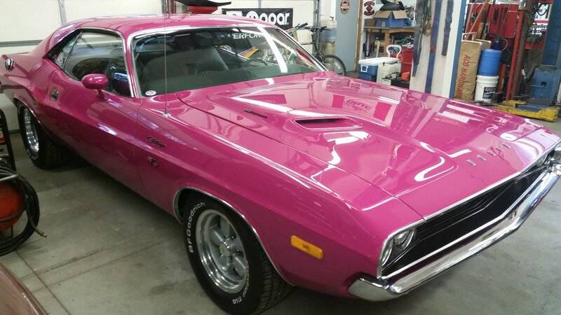

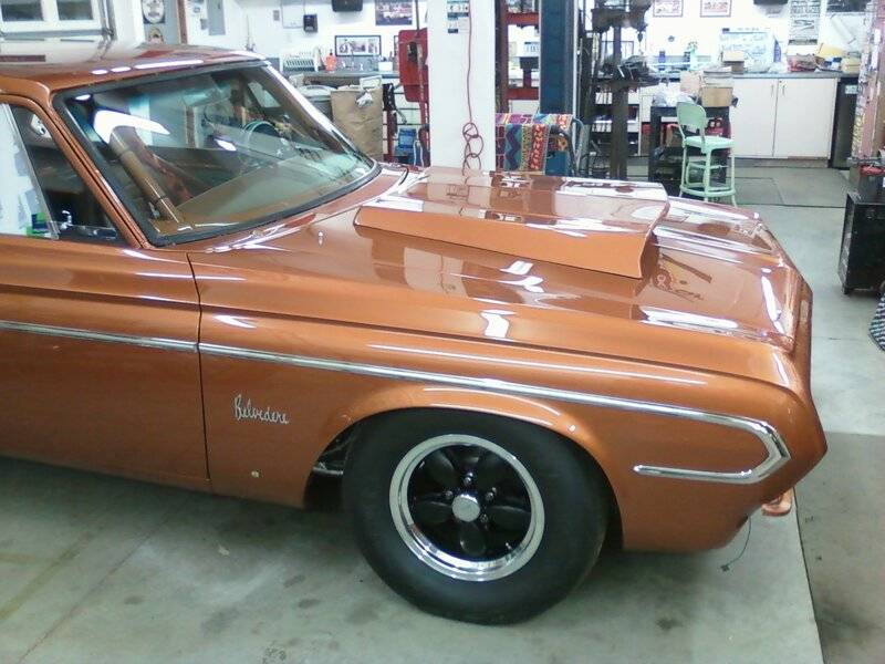

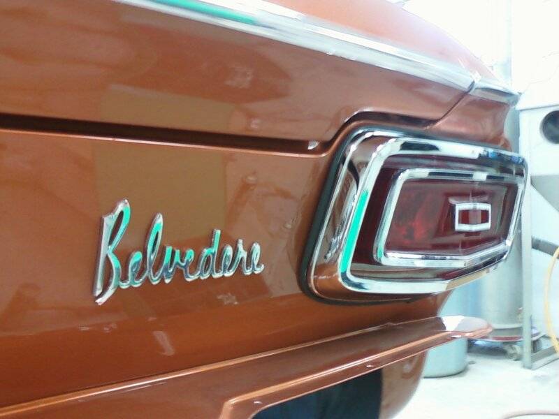

You have anodized aluminum. You can repair that trim. It's time consuming. The anodizing can be chemically removed with lye or sanded off. The dent can be pushed out with a variety of pics, screwdrivers or hunks of wood. Then block sand slightly to look for low and high spots. Pic the low spots up and recheck. Once you a very close, block sand to remove dimples. Sometimes little dimples will remain. Leave them as you may create more trouble than its worth to get them out. Then its just a matter of finer and finer grits up to 1500-2000. Then polish. No need to reanodize. I have some that was reanodized. and some that wasn't. 17 years latter they look the same. In fact if it polished once in while the non anodized is shinier. Stainless can be done as well. It much tougher to sand and bend. Here's some examples of smashed trim that have been repaired at home with minimal tools. The Challenger headlamp surround and hood molding were smashed pretty good. They are alumninum. The RF spear on the Belvedere and the trunk and corner 1/4 panels moldings were also heavily damaged. They are stainless.

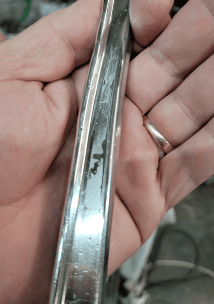

The trim I am looking at is stamped aluminum. Quite thin... but I have nothing to lose. Did sand it a bit with 400 to cut through the scratches. Here's what I am seeing. Is it possible I am looking at the anodizing?
A few people have chrome plated their trim. I have not seen any posts saying it was successful. Ours was stripped and we just polish.
If it were mine, I would chemically strip the anodizing then try sanding. I would start with 1000 grit. I did some stainless and started with 600 grit on it. Some of the others have suggested pick and filing. It will be tedious.

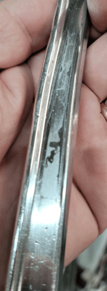

Awesome outcome... thanks guys. I have a lot of work yet to do but damn... this looks good.
With scratched anodizing and now without.
