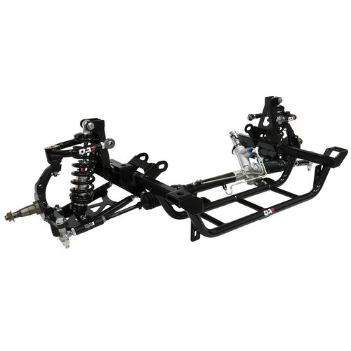

I have 2 cars with manual rack and pinion. Haven't driven the Hemi Road Runner yet. I personally like the rack and pinion. You can go power rack and pinion. I have Gerst tubular, now QA 1 owns it, and has modified it to make most of it their own so no cross over between who's is who's. Some will argue design.

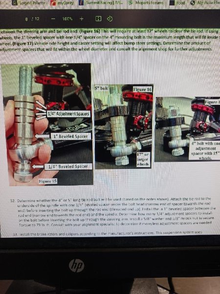

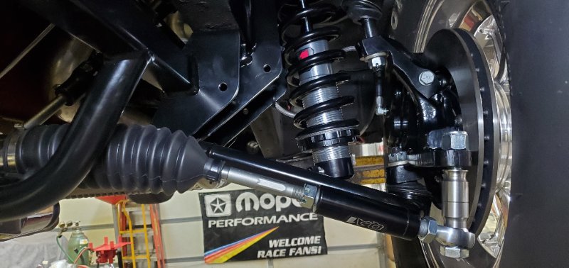

It was a newer QA-1. I was told was their later deal copying Gerst. I haven't seen a Gerst so don't know about them. When asked about the bump steer they told me I didn't understand what I was talking about. Shortly afterwards they publish the instructions shown in post #3. It's exactly what I told them. Personnally don't like the outer tie rod hanging way down from the steering arm.
Doug
I agree. A cantilevered tie rod connection was a crutch to make it fit and have less bump steer but it just looks like a huge compromise.

Be careful adding a ton of abitrary caster. From the Chrysler tech paper on bump stee; For every one degree of caster change the outer tie rod moves vertically .100". This .100" movement causes the wheel to steer aproximately 3/32", x 2 for two wheels. Example ; Say you have a perfect toe pattern at the factory setting of 3/4 degree degrees. Now at 8 degree's you have individual wheel steer (bump) of 3/4". Thats a 1 1/2" of total toe change throughout the travel. It would take raising the outer tie rods just over .700" to reestablish zero toe change.
Doug
