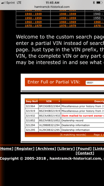

If your 8 digit vin shows it’s from the Hamtramck plant there’s a pretty solid registry online that allows you to search their records with the partial. It is all based on what’s been reported to the site though so they don’t have everything. I was able to find that my original car was either a duster or a barracuda based on the sequence Of the vin. (My engines full sequence has never been reported to them) Yours may have been in the past and you may find out more

The hamtrack registry does that for you. I looked up the full 8 digits I had and got nothing and kept deleting a digit from the end until I got any results back. Got down to “0b321” and it showed what vins that had been reported 0B321295 was a duster and 0B321852 was a barracuda. I’m leaning to mine being a duster, but always hold out hope that it was a cuda. My engine has 1970 J heads which if original I believe the original engine would have to be a cuda but again who knows if the are original. the screeen shot is what it looks like when you look it up

Ok, the last eight are... 1B267250. So, it was a Hamtramck car - and for 1971 that means either a Barracuda, Challenger, Demon, Duster or Valiant. However the Registry is for 1970 models years only, so I guess that's as far as I can go for now.
Yours does have a colder trail. From what I looked up the closest I got was 1b266462, which was a duster but almost 1000 cars were made between that one and yours

Looking again it has 1b269513 which was also a duster. Since yours falls between those it’s a very strong case that your engine came from a duster
