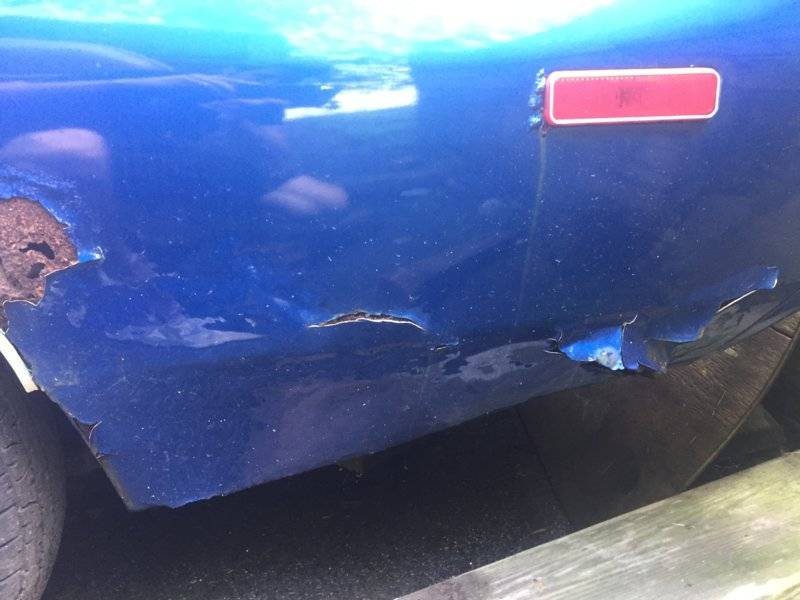

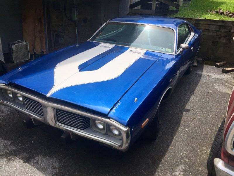

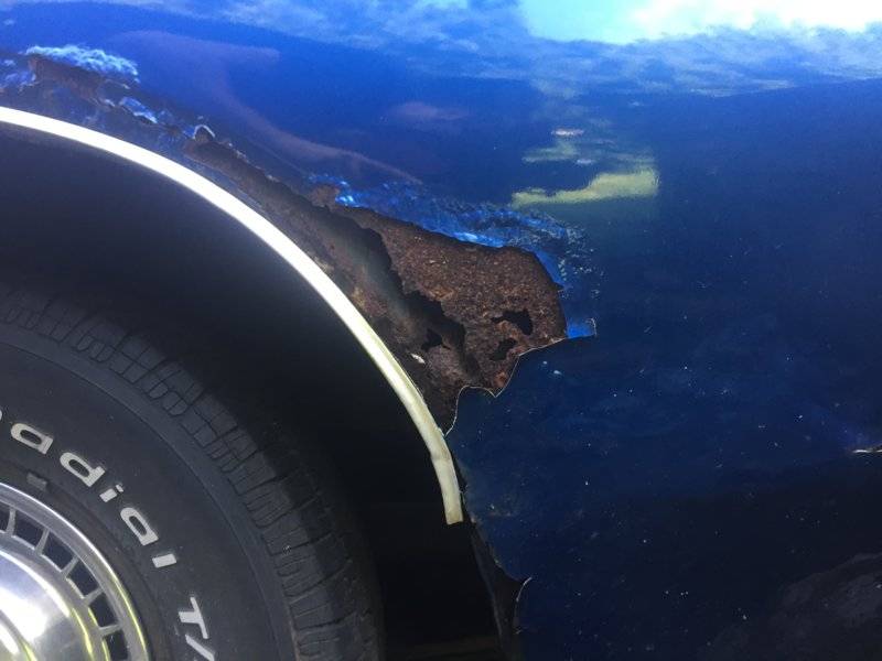

Ive got a 73 Charger I’ve had since I was 19, it was my first car, been in the family from the show room floor. Nothing fancy, 318 with bench seats and non ralleye gauges, not flashy but it’s cool. I was thinking about selling it as I haven’t done anything with it in years and it needs some love. After a wash and some time letting it run I’ve kind of fallen back in love with it and am leaning towards keeping it. I’m looking for some guidance and suggestions for the order I should do things. The fuse block is melted in spots and wiring has seen better days. Safe to say it needs to be rewired. The engine has blown it’s freeze plugs all over including the ones near the back of the motor. It probably should be rebuilt anyways as it has never been (no clue what it costs to get a mild 318 built). Finally there is rust popping through the paint that needs to be addressed (especially the rear quarters!) I’m wondering what order I should do these repairs in, as I financially can’t do them all at once. Thanks!

Nice. Welcome. Pictures.

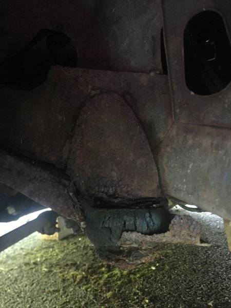

Last picture is of the K frame that will need to be replaced or fixed. Definitely has seen better days.

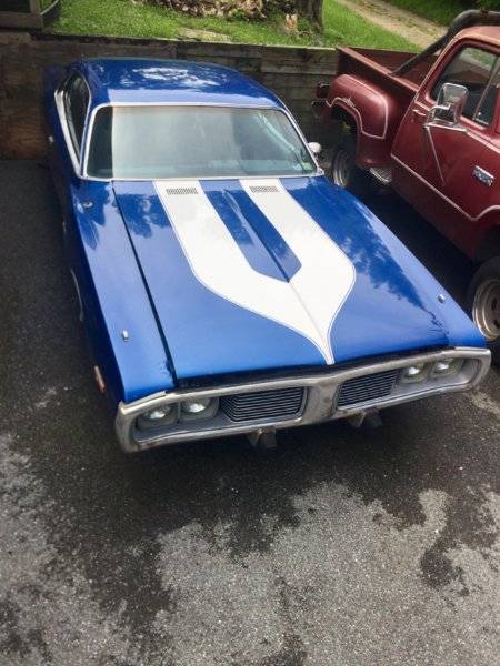

I like the truck too. WTH do they use on the roads in Maryland?
There is only one place making quarter skins - Tabco. They aren’t bad as far as skins go. Are the freeze plugs rotted or did the block freeze? Running 318s are not hard to find for less than a rebuild. I’d start with the wiring and then get it running for the simple fact that body shops seem happier when the cars don’t have to be pushed.
I think it’s that brine solution they de-ice with now that killed the body. One of the state highway guys said to get that stuff off ASAP or it’ll eat your car away. Guess who learned that a few years to late lol... the freeze plugs have rotted. I’ve got eyes on a few of them and once I cleaned the schmutz out from around them the holes showed themselves.
Thanks though about the truck. 79 dodge warlock 360 4 speed 4wd. Think I’m gonna have to sell it to finance the Chargers rebuild journey

Agree that wiring is most important but I would get a quote on that body work before anything. Body work is the most variable on price and depending what your budget is, it may make you reconsider diving into this. Pull up the carpets because if the quarters are that bad there may be more hidden.
that's not just the K frame that's rusted through-
it's the "fish plates" that reinforce the threaded inserts the bolts go in.
not the easiest repair unless you're a good fabricator and welder
Yeah I’ll be honest, I wasn’t planning on spending 15,000 on body work no. At the end of the day it’s a plain Jane 73 charger, nothing special at all, just means a lot to me. Time really isn’t an issue. At the end of all this, she doesn’t have to be a trailer queen or anything like that, but I would like to knock the rust out and get some paint back on her. This will be my first stab at body work. There’s plenty of small bits of rust here and there all over it so I’ve looked at ways to remedy that. I’ve pulled all the carpet up and headliner down, and found a small hole in the floor board on the drivers side. Easy fix there. As for the other smaller spots I was thinking glass and puddy. The back quarters will probably just have to be replaced to make it easier. I imagine that’ll be expensive. As for the K frame, I’ve fabricated some frame work before on the truck pictured next to it, so I was hoping that if I can’t find a replacement, to just fabricate something to support it and make it work. I think I’ll take the advice though to get a quote on the body work, and then go from there. The killer for me is I’m sure trying to sell the Charger in the condition it’s in, it won’t fetch much at all. So I’d hate to see it go for next to nothing and always wonder what could have been.
