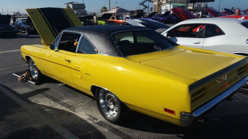

I have read about these and 3 pedal cars like my 70 Roadrunner.

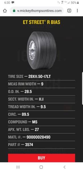

My rear 9x17 Year One aluminum Rallye wheels are the width and diameter MT recommends, I hope they fit in the rear quarter wheelwells.
https://www.mickeythompsontires.com/drag-tires/et-street-r-bias

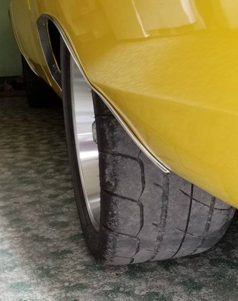

I have 315/35/17 Toyo Proxes TQ drag radials on my stock suspension 70 Roadrunner now, have for 2 years, ever since I put the Year One aluminum Rallye wheels on. They fit like Plymouth should have made them standard equipment! They have a pretty short sidewall compared to the MTs though.

The Toyo Proxes TQ drag radials are the only tires I've had on the back of my Roadrunner since I got the 17" Year One aluminum Rallye wheels. I use them for everything, including the occasional track trips. They've been great for driving, but off the line traction, while much much better than the BFG T/A Radials were, leave a lot to be desired.

That is an option, but I know for a fact that the 5" backspaced 9"wide Year One aluminum Rallye wheels center a 10.5" wide tire perfectly in my rear quarter wheelwells.

That 345/40 is suggesting a 1" wider wheel than the 315, and I'm already "cheating" with my 9" wide wheel when Toyo recommends a 10.5" min. No sidewall pucker to speak of, but the 345 minimum recommended wheel is a 11.5"

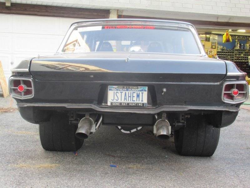

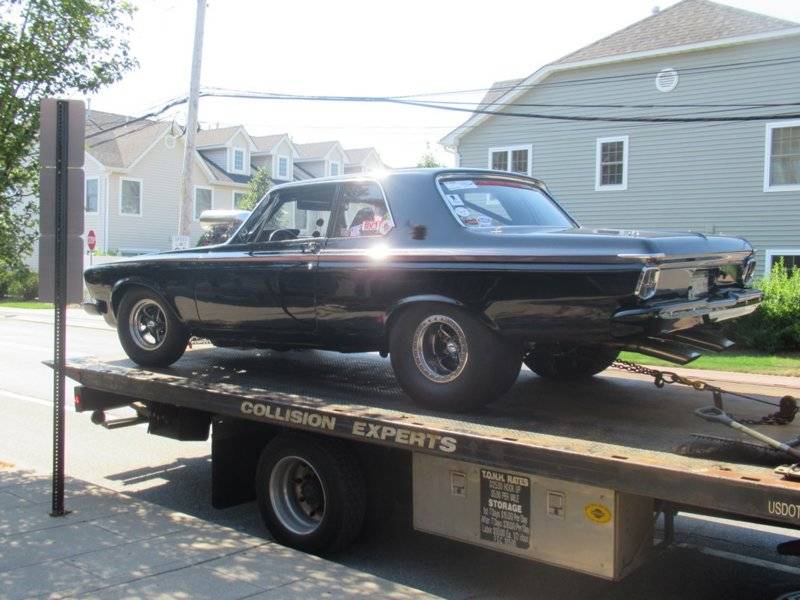

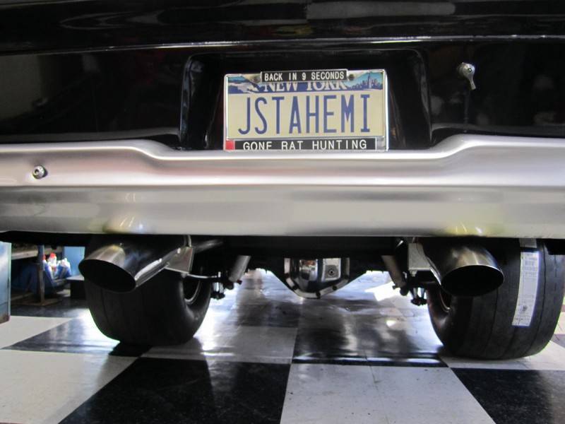

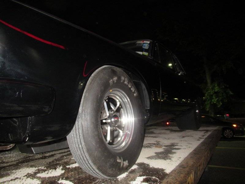

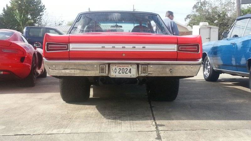

I love BIG FATTIES in the fenderwells...
But BIG FATTIES under a B-Body CAN'T BE BEAT!
:lowdown::moparsmiley:

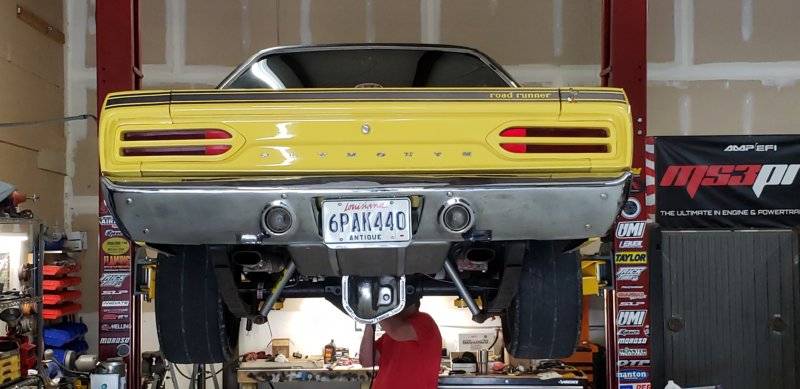

One day my Roadrunner is going to go from this (which ain't bad):
To THIS! :bananadance::carrot::fool::bananaweed::lowdown:BIG FATTIES
