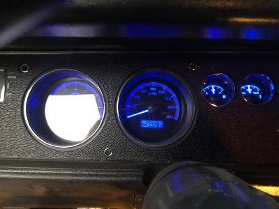

Today I was out in my '70 Charger rowing the gears and loving the rumble and growl. At one point, the gauge panel went dead.
In 2015 I swapped in a Dakota Digital setup. They have been trouble free since I installed them.
I drove back home and as I was growing closer, the gauges started working again. I shut the car off and started it three times to see if they would fail but they seemed okay again.
Later as I was leaving a gas station, the needles of every gauge started doing slow sweeps left and right. This is some default action that they do when a malfunction is detected.

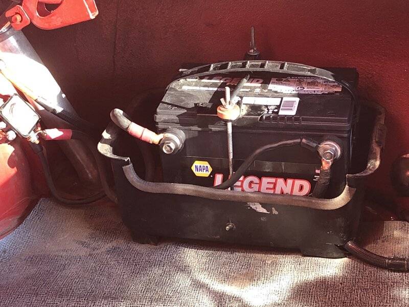

I planned to remove the cluster. First thing was to remove the steering wheel. 5 Allen screws and it is off. OOoops! I need to disconnect the battery, right?
The bolt holding the 2 negative battery cables was loose!
The engine started fine, ran fine....The radio didn't indicate any trouble. The heater fan motor spun normally too.
It seems that any other time that I've had a loose battery cable, the terminal throws a spark and the car won't turn over.
What the heck???
