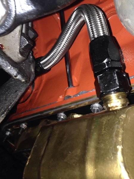

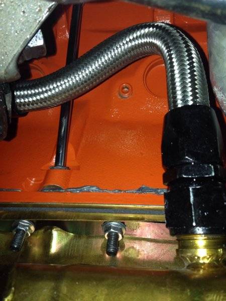

Heads are 270 Trick Flow's. I was told that they were already restricted and that no further would be needed. I took off the pump cover, saw no signs of the rotors from the pump beating it. Saw just light skid marks that were very very fine. Here's a picture of the pickup hose, I don't think its that major of a turn, but would it be enough for it to collapse and start slowly loosing pressure?
Yep, it really sounds like the rubber inside the hose is blistered and sucking closed. Those symptoms are exactly what I had when losing oil pressure like that on that damn 528 hemi.

If it is an internal blister, you should be able to see deformation on the internal wall. If so, I'd replace it with a teflon lined hose.
Also come out of the bottom port with a 45 degree hose fitting or adapter to reduce the hose bend radius. The hose blistering may not show up unless at temperature. If that is a pickup line you may have vacuum exacerbating the problem. In any vacuum situation make sure the hose is rated for it. Even Teflon will collapse under vacuum unless it has an internal support coil.

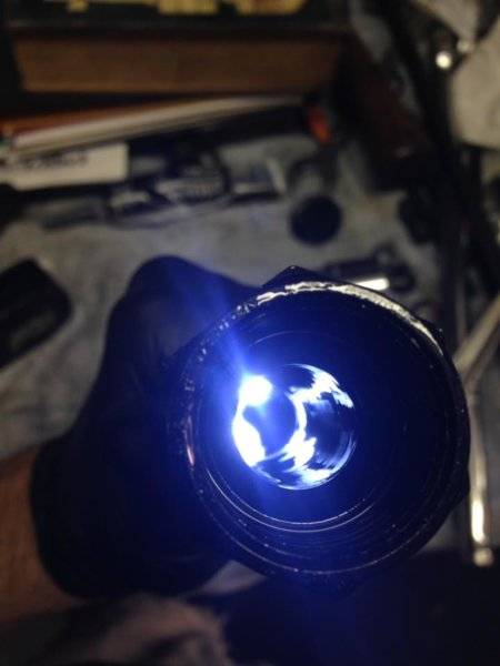

Here it is... External line blistered up on the inside. Thank you all for the help, so heres the question... Is it the oil temp that caused this, too much of a turn in the hose, OR was it a defect in the hose itself? I was unable to find any hard line tubing in -12 out there, maybe I'm typing in the wrong info, but I sure have seen it before. I'd much rather go hard line and never think about this again. Either way in running an inner support the second best option?
Tubing should be readily available. Check McMaster Carr. Get seamless tube so you don’t have to double lap flare.
make your own hard line. as for the blister in the hose could be many different sins that caused it. what is oil temp running and do you have a oil cooler on it.
where did you get the hose from and what was the hose rated at temp and pressure. for the most part blisters or flaps are from twisting the hose and heat.
