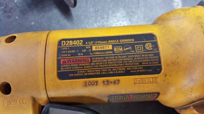

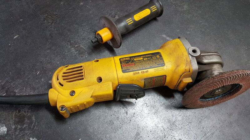

Was cutting some metal with the old Dewalt and a cut-off wheel, the blade caught and sent the grinder across the shop floor, smashing and banging along the way. Smashed the blade up so went to spin it off but the blade lock would no longer work, and now there is a bunch of resistance and a nasty grinding noise when I turn the blade by hand.
Guess after 20+ years of faithful service it was the final drop that sent it on it's way to tool Valhalla.:(

Check the brushes.
It sounds like one may have come apart.
I thought I had lost one of my angle grinders (a $15 pawn shop special that has held up well) and luckily found one in the dumpster the next time I needed to use one (yeah, my life is like that sometimes). I finally got around to throwing the old one away after removing the wheel, and decided to check the brushes.
One of them was badly cocked and worn at a severe angle.
I hit it with the grinding wheel, back down to level, reinstalled and it worked perfect.
Om my compound, sliding mitre saw, I had almost the same issue except it would run if you spun it by hand.
On that one, simply turning the brush around fixed it.
Kind of sounds like yours may have broken a spring.

I don't think the damage is in the motor, but in the head with the gearing. Since the blade lock no longer works, and when I spin the blade and hold onto the head it sure feels like the gears have broken and no longer meshing properly.

This evening I got the broken blade off and plugged it in and tried it...motor powered up but shaft would not turn, and I was sad. So shut it off and gave the head a whack on the bench and tried it again and now it works! No idea if this will last or fail again once there is a blade in place but it's a turning for now.
