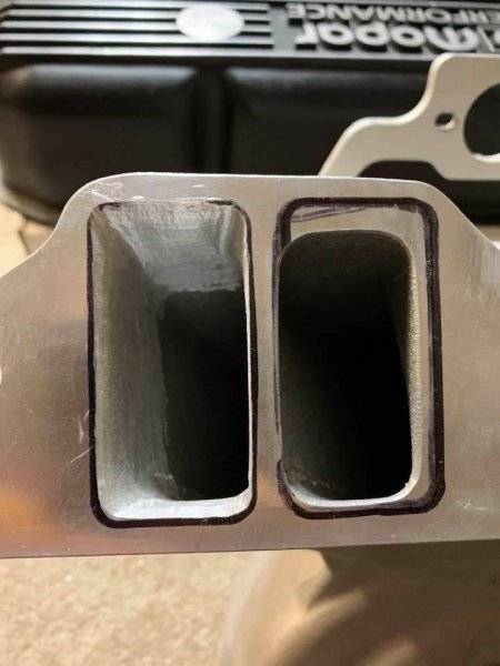

I'm in the middle of opening up a Trick Flow Track Heat intake to match my TF 270 heads. Looks like it can be done but there is not much meat left on top of the runners. It will probably work but if your working with heads or a block that have been decked it might be a problem. I tried to buy a Indy low deck MW intake but last I checked they were back ordered.

Something fairly stout with TF270’s on it, tested with the ootb TF manifold vs one that the only work done to it is similar to what’s in the pic above(port matched only).
