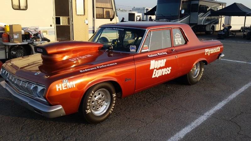

Wow....thanks DVW and Tommy...but this is getting way above my paygrade (and knowledge) and check book (LOL). I now have the tranny out of the car to check all of the internals...will have the results of the checkout of the tranny parts, clutches, etc next week.
Going to get it all back together and run it Feb 22/23 at the test and tune weekend and whatever it runs will be what it is.
I am getting my NHRA Competition License at that test&tune so I can run in the 9s with no problem with the track officials.
I will be running it wide open with the adjustable restrictor plates set at full open. I will trying different shift points, different launch rpm's off the brake, etc, etc....and see what it does...

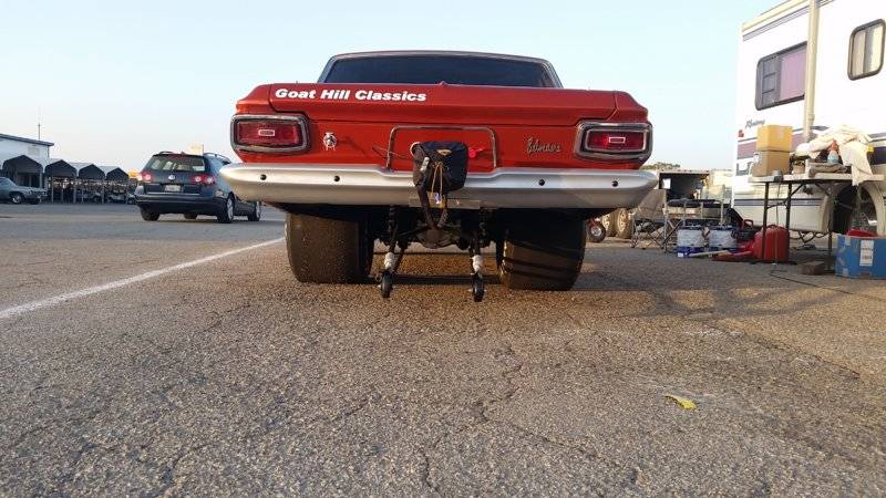

Again...thanks for the input and I will be sticking with the Torqueflite with standard low gear set and my current converter, 4.56 gear and 105" rollout slicks and the wheels on my wheelie bars set at 8" off the track.

Perfect Mike.... But I think you'll find that your shift point will be around 7300 with your combo.
Set shift light at 7100.
By the time you shift you should be right where you want to be.
I find short shifting 1st gear usually nets me the best ET.
I shift 7200 in 1st and 7400 in 2nd and 3rd.
I think your Hemi should be very similar to mine.
Good luck and report back!

Yes it has gone a bit off thread, never mind no big deal:) I got an idea of what its gonna be like on the hit, just hope we don't have to put w/bars on the rear, he won't like that driving with them on the street!!!!
Wheelie bars on a street car is cool, but only if you can PROVE you NEED em ! There was a guy locally that drove his 63 around with wheelie bars. The only way he was getting the front end off the ground was with a floor jack.
