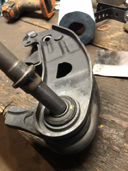

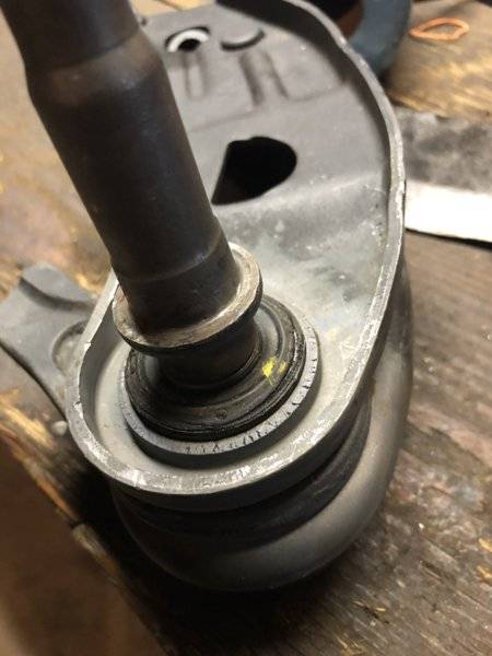

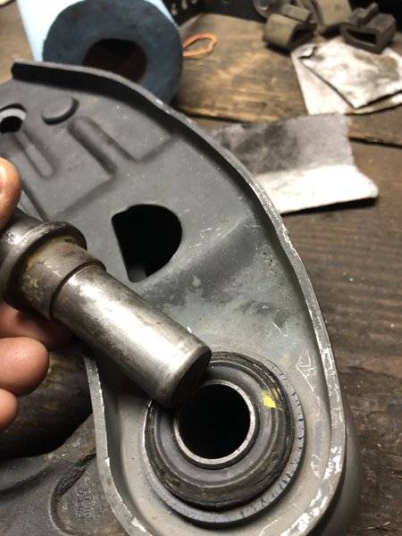

Ok thanks for response I am ok with getting the pivots tight in the k member but I can pull the LCA off by hand also I put photos on here after that spins I can remove the shaft by hand and put it back in by hand is this going to be ok for back and forth movement or will it eventually push back the torsion bar? Like I said I have no problems holding the pivot shaft with a pair of vice grips and getting it tight

If you can spin the shaft in the bushing, something is not correct. The bushing is pressed onto the shaft, then the shaft/bushing assy is pressed into the LCA. The only spinning when done is the torsion bar lever for adjustment.

I had one lower shaft in my LCAs that would spin when I tried to remove them and had to resort to vice grips. I wrote it off as a worn shaft and replaced them with new ones from PST and re-installation was normal.
You may be dealing with something different - not sure.
Looked online for images, same have a step like yours some don't. I'd measure pivot shaft and call around, PST?

Yep, that is not right at all. Maybe worn pivot shafts or oversized sleeves.
