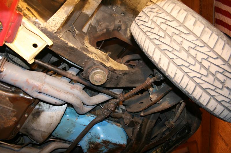

I got over to the shop last night and with some of your help i'm certain I got it figured out !

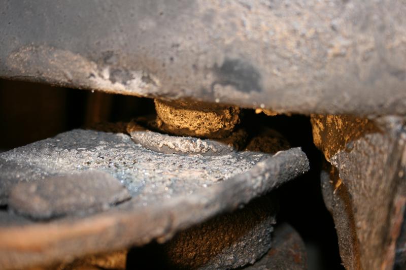

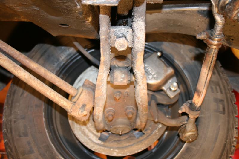

the lower control arm bushing is almost gone , It was really hard to tell being all covered in grease. The arm , though its got some scrapes in it , looks straight.

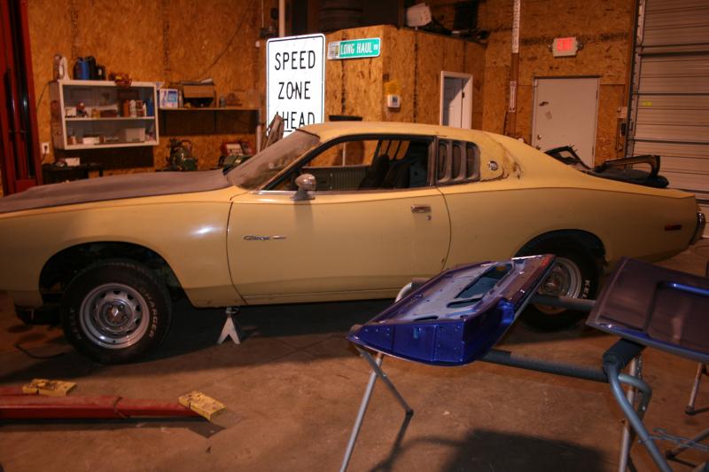

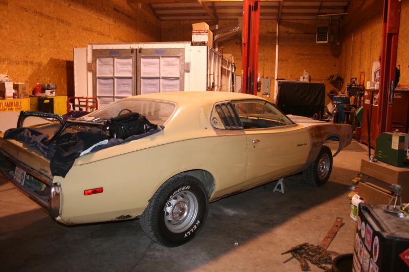

I got the replacement fender bolted on solid and lined up well and jacked up the torsion bar to get it level , the passenger side adjuster bolt is in about 3/4 of an inch vs. the driver side and there is plenty more thread left about another 1/2-3/4 before its bottomed out.

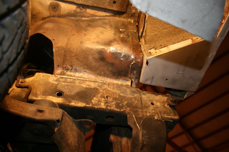

the small area that was wrinkled above
