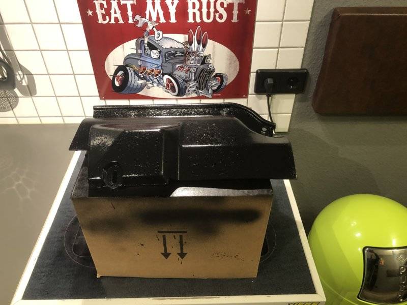

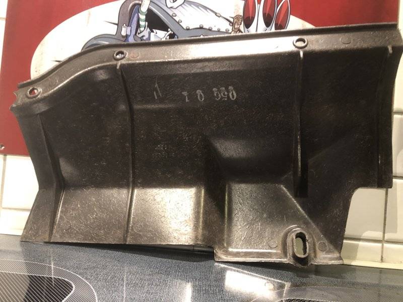

Hi guys, can anyone tell me for what are this oval hole in the lower dash cover ? Under dash light ???
and maybe someone can send a picture in installed position , because near this hole I have a small treaded stud coming from the acc/air-vent Box, but not fit in this hole from the dash cover about half inch beside
Something must be mis-aligned because that slotted hole fits over the stud you mentioned. Gets a flat washer and a nut. It is only a means of fastening the bottom of the panel. If you have a map light, it fastens to the bottom lip of the dash panel. Non A/C cars didn't use that panel.

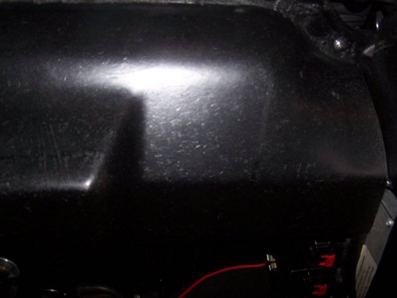

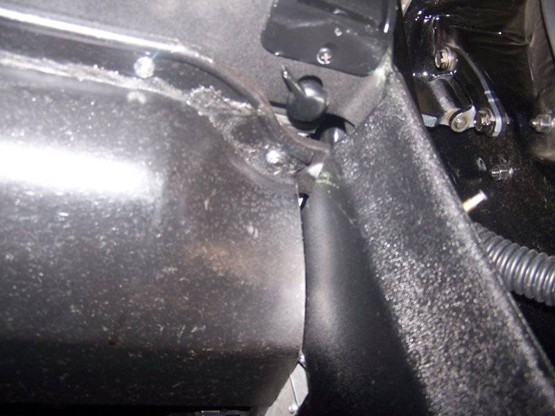

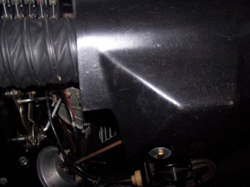

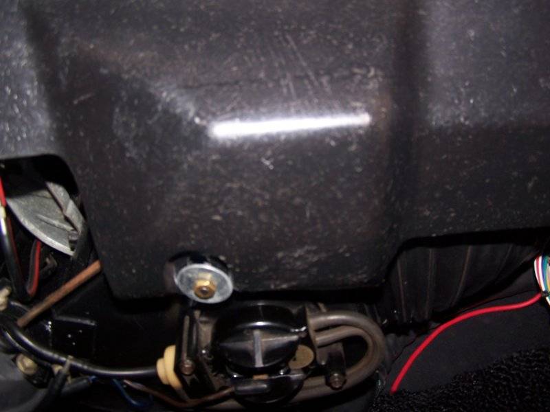

I just took some pics of mine. Although mine has had some modifications since I have the computer for my 6.1 mounted on the kick panel. It didn't change the mounting of the fiber panel though. Mine is tight to the kick panel too and my kick panel has been cut to make room for the wiring plugs. I'm sure it was designed to cover the fresh air hose assembly from happy feet. Not sure why yours could be 1/2" off. My pics don't really show much though so don't know how much help they could be. Sorry.
View attachment 863150 View attachment 863151 View attachment 863152 View attachment 863153
thank you so much ! You’re pics specially the first and last help‘s me enough I think . Great , thank you !
