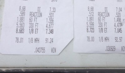

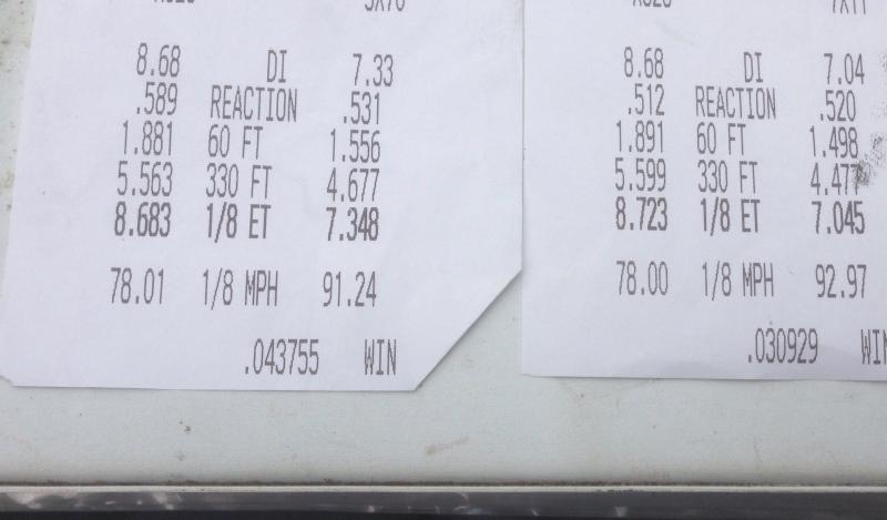

Time tickets
Ok here are the last 2 runs. Looks like it was my 330 that was off. Apparently I didn't hit that shift as good as I thought. Ticket on left I'm against #2 in points & missed the tree. Car ran the #. Ticket on right I'm against the points leader & nailed the tree. So maybe it was a quick shift. Sucks cause this guy is hard to beat & I had him in my gun sights. Runs where 50 minutes apart. 8 pm vs 9 pm. Temps the same. They did hold us in the water box a bit while they reset the tree. Don't think that affected it though. Car temp was the same.
This is what I do. Subtract your incrementals. This will show if it was down on power, traction, or missed shift.
8.723-5.599=3.124
8.683-5.563=3.120
only .004 difference, not power related
5.599-1.891=3.708
5.563-1.881=3.682
.026 difference, highly probable the shift point was missed. Add the .004 and we now have 75% of the .04 ET loss. Far more drastic than the .01 loss in 60 ft which I believe was probably a result of being in a little deeper. Which R/T is closer to your ave R/T? A .077 spread in R/T is huge.
Doug
That's pretty clever. It does look like a missed 1-2 shift. My R/t is typically high 20's to low 40's. So let's say average is .035. Funny thing is I knew who I was running & got up on the wheel. As I hit each shift I thought to myself that I nailed that one. Kept the car straight. The data as you pointed out doesn't back that up though. I run muffs for two reasons. It gives me a bit more lower end & I can hear the fast cars comming. This opponent runs muffs too & I was surprised when he came up on me & I could see he was ahead at the stripe. Oh well. Thst is a useful way to read the tickets. Thank you for sharing that
