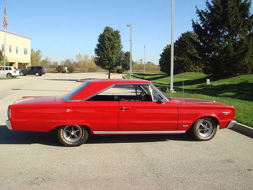

How do you lower a b-body... for instance my 67 belvedere II, its definatly set to have the gasser look, I do want to drop it to have a more subtle look.
does anyone know how to lower teh car using the torsion bars?
right now im at this:
as you can see the ft fender is about 3 inches above the top of the tire.
What I want:
either just at or just past the the top of the tire tread with the fender.
