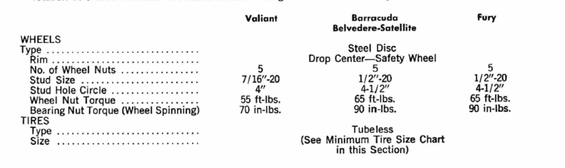

From the 1970 shop manual:
That torque value applies to stock steel wheels. Aluminum wheels have higher torque requirements. For instance, my Billet Specialties wheels call for 75-85 ft. lbs. Best to check with the wheel manufacturer, torque to their specs, drive the car a few times and then recheck the torque.
